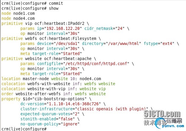

crm(live)configure# primitive webfs ocf:heartbeat:Filesystem params device=/dev/sda1
directory=/var/www/html fstype=ext4 op monitor interval=30s
crm(live)configure# colocation webfs-with-website inf: webfs website
                    //将webfs和website绑定在同一个节点上
crm(live)configure# order website-after-webfs inf: webfs website
                    //设置启动顺序,先启动文件系统webfs,再启动服务website
此时查看资源状况
服务运行在master node4.com上,当master宕机,资源会被备用节点node1.com接管。
