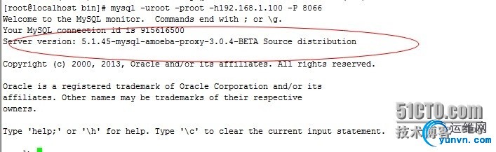

四.启动amoeba
[iyunv@localhost bin]# ./launcher
The stack size specified is too small, Specify at least 228k
Error: Could not create the Java Virtual Machine.
Error: A fatal exception has occurred. Program will exit.
发现错误
在amoeba程序的根目录里有一个jvm.properties 优化设置
JVM_OPTIONS="-server -Xms256m -Xmx1024m -Xss196k -XX:PermSize=16m -XX:MaxPermSize=96m"
设置为
JVM_OPTIONS="-server -Xms256m -Xmx1024m -Xss300k -XX:PermSize=16m -XX:MaxPermSize=96m"
只要大于上面提示的228K就可以了
10
11
12
13
14
2014-09-03 18:01:17 [INFO] Project Name=Amoeba-MySQL, PID=1086 , starting...
log4j:WARN log4j config load completed from file:/usr/local/amoeba/conf/log4j.xml
2014-09-03 18:01:19,883 INFO  context.MysqlRuntimeContext - Amoeba for Mysql current versoin=5.1.45-mysql-amoeba-proxy-3.0.4-BETA
log4j:WARN ip access config load completed from file:/usr/local/amoeba/conf/access_list.conf
2014-09-03 18:01:21,513 INFO  net.ServerableConnectionManager - Server listening on 0.0.0.0/0.0.0.0:8066.
OK了,查看下端口
10
11
[iyunv@localhost bin]# netstat -natpl
Active Internet connections (servers and established)
Proto Recv-Q Send-Q Local Address               Foreign Address             State       PID/Program name
tcp        0      0 0.0.0.0:22                  0.0.0.0:*                   LISTEN      932/sshd
tcp        0     52 192.168.1.100:22            192.168.1.2:62555           ESTABLISHED 965/sshd
tcp        0      0 :::22                       :::*                        LISTEN      932/sshd
tcp        0      0 :::8066                     :::*                        LISTEN      1118/java
tcp        0      0 ::ffff:192.168.1.100:8260   ::ffff:192.168.1.101:3306   ESTABLISHED 1118/java
tcp        0      0 ::ffff:192.168.1.100:8258   ::ffff:192.168.1.101:3306   TIME_WAIT   -
tcp        0      0 ::ffff:192.168.1.100:58189  ::ffff:192.168.1.102:3306   TIME_WAIT   -
tcp        0      0 ::ffff:192.168.1.100:58191  ::ffff:192.168.1.102:3306   ESTABLISHED 1118/java
登入
amoeba 账号和密码可就是主配置文件里设置的
