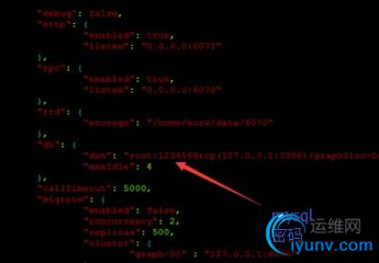

cd graph
mv cfg.example.json cfg.json
vim cfg.json
./control start  (启动)
./control tail  (查看是否报错)

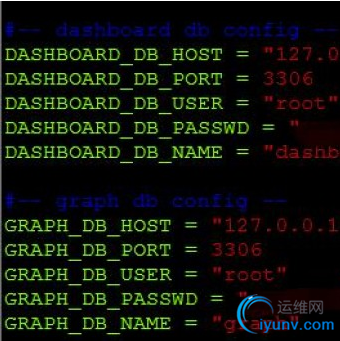

vim gunicorn.conf
vim ./rrd/config.py

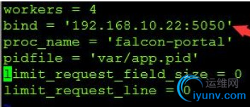

cd portal
virtualenv ./env
./env/bin/pip install -r pip_requirements.txt
vim gunicorn.conf
vim frame/config.py
