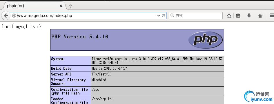

4、建立与httpd服务主机上相同的网页路径,测试php和httpd连接是否正常。
10
11
12
13
14
15
16
17
18
19
20
21
22
23
24
25
[iyunv@bogon ~]# mkdir -p /web/host1
[iyunv@bogon ~]# mkdir -p /web/host2
[iyunv@pxe130 ~]# vim /web/host1/index.php
host1
<?php
$conn = mysql_connect('192.168.1.113','test','test');
        if ($conn)
                echo "mysql is ok";
        else
                echo "mysql is bad";
phpinfo();
host 2
<?php
        if ($conn)
                echo "mysql is ok";
        else
phpinfo();

3、测试
ok此时我们的LNMP环境就部署完成了。

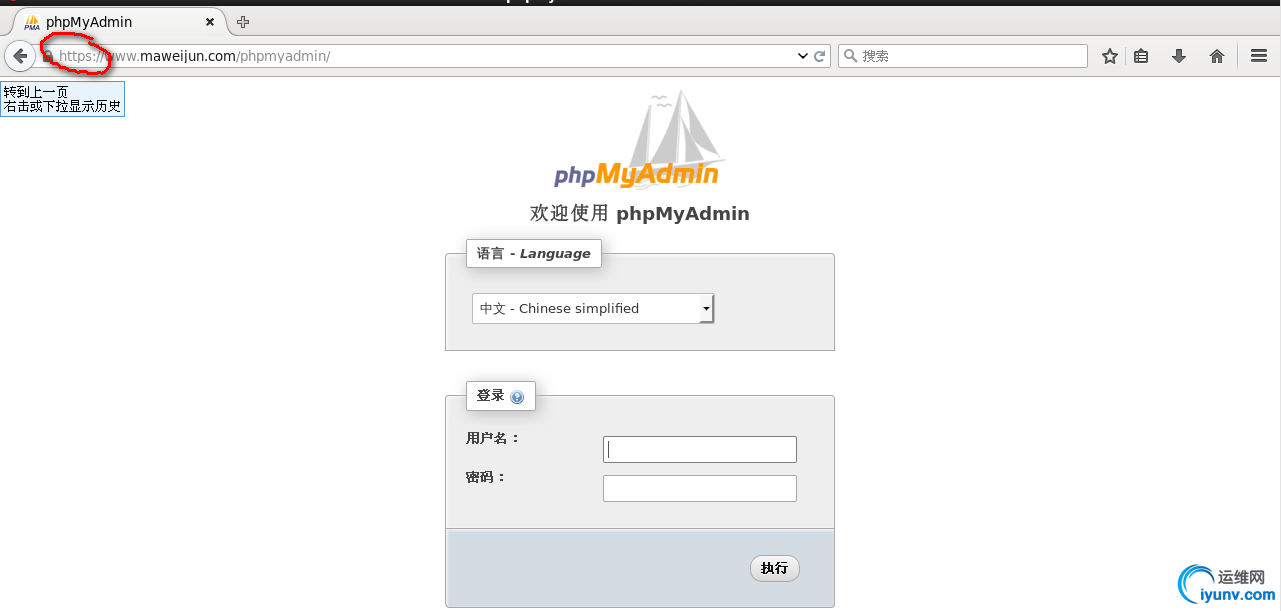

三、为其中一个站点设置为https方式访问
(1)建立CA
[iyunv@pxe130 CA]# (umask 077; openssl genrsa -out /etc/pki/CA/private/cakey.pem 2048)
[iyunv@pxe130 CA]# openssl req -new -x509 -key /etc/pki/CA/private/cakey.pem -out
/etc/pki/CA/cacert.pem -days 3655
[iyunv@pxe130 CA]# touch {serial,index.txt}
[iyunv@pxe130 CA]# echo 01> serial
(2)httpd服务生成密钥及生成请求证书
[iyunv@bogon ~]# mkdir /etc/nginx/ssl
[iyunv@bogon ~]# cd /etc/nginx/ssl/
[iyunv@bogon ssl]# (umask 077;openssl genrsa -out /etc/nginx/ssl/nginx.key 2048)
[iyunv@bogon ssl]# openssl req -new -key /etc/nginx/ssl/nginx.key -out
/etc/nginx/ssl/nginx.csr -days 365
scp nginx.csr root@192.168.1.110:/
(3)CA上签署http证书申请:
[iyunv@pxe130 CA]# openssl ca -in /nginx.csr -out /etc/pki/CA/certs/nginx.crt -days 365
[iyunv@pxe130 certs]# scp nginx.crt root@192.168.1.104:/etc/nginx/ssl
(4)编辑httpd配置文件:
10
11
12
13
14
15
16
17
18
19
20
server {
        listen       80;
        listen       443 ssl;   ###指定使用ssl,且监听443端口
        ssl_certificate  /etc/nginx/ssl/nginx.crt; ###指定公钥路径
        ssl_certificate_key  /etc/nginx/ssl/nginx.key; ###指定私钥路径
        server_name  www.maweijun.com;
        location / {
            root   /web/host2;
            index  index.php index.html index.htm;
        location ~ \.php$ {
            root           /web/host2;
            fastcgi_pass   192.168.1.110:9000;
            fastcgi_index  index.php;
            fastcgi_param  SCRIPT_FILENAME  /web/host2/$fastcgi_script_name;
            include        fastcgi_params;
(5)测试
