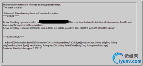

[08/17/2016 02:30:55.0977] [2] [ERROR] Active Directory operation failed on contoso.com. This error is not retriable. Additional information: Insufficient access rights to perform the operation.Active directory response: 00002098: SecErr: DSID-03150BB9, problem 4003 (INSUFF_ACCESS_RIGHTS), data 0
[08/17/2016 02:30:55.0977] [2] [ERROR] The user has insufficient access rights.

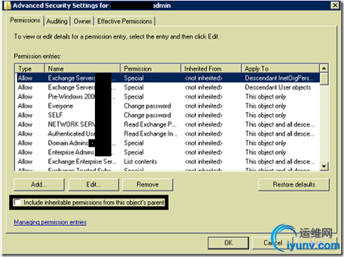

2、通过查找相关KB,其中有人遇到类似是问题,解决方法是当前安装账户为继续权限。经过我的检查,我遇到问题时,安装账户已经继承了权限。(此方法可以作为一种解决此类问题的一个方法。),具体可以参考:http://www.petenetlive.com/KB/Article/0000719
