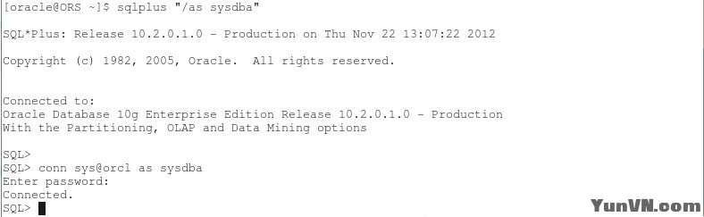

接着输入:
$ sqlplus "/as sysdba"
原本的画面会变为
SQL>

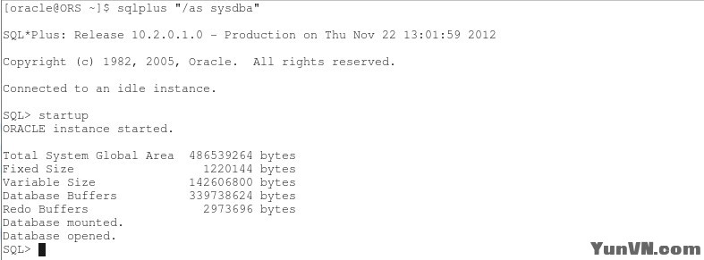

接着请输入
SQL> startup
就可以正常的启动数据库了。
另外停止数据库的指令如下:
SQL> shutdown immediate

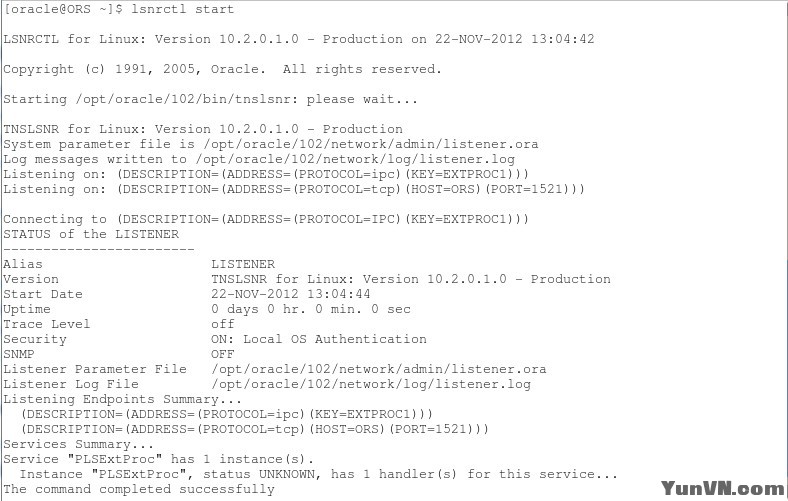

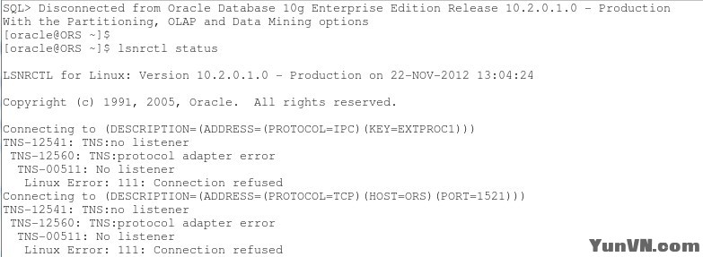

二、检查Oracle DB监听器是否正常
回到终端机模式,输入:
$ lsnrctl status
检查看看监听器是否有启动
如果没有启动,可以输入:
$ lsnrctl start
启动监听器
SQL> conn sys@orcl as sysdba
然后输入密码,sys以sysdba身份登入数据库。

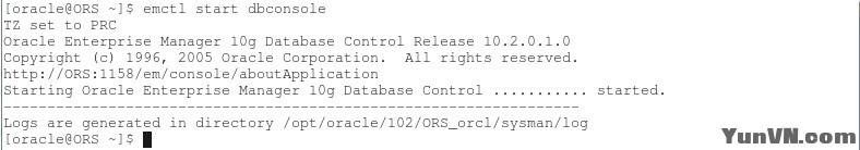

另外也可以发现http://localhost.localdomain:1158/em 目前是没有反应的,这边要另外启动,启动的指令如下:
$ emctl start dbconsole
这个指令运行时间较长,执行完的画面如下:
手动启动Oracle数据库完毕,下面创建系统自行启动Oracle的脚本。

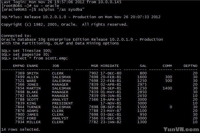

a. 开机自启动
Last login: Mon Nov 26 19:57:06 2012 from 10.0.0.145
[iyunv@ORS ~]# su - oracle
[oracle@ORS ~]$ sqlplus "/as sysdba"
SQL*Plus: Release 10.2.0.1.0 - Production on Mon Nov 26 20:07:33 2012
Copyright (c) 1982, 2005, Oracle.  All rights reserved.
Connected to:
Oracle Database 10g Enterprise Edition Release 10.2.0.1.0 - Production
With the Partitioning, OLAP and Data Mining options
SQL> set linesize 300;
SQL> set pagesize 30;
SQL> select * from scott.emp;
     EMPNO ENAME      JOB              MGR HIREDATE         SAL       COMM     DEPTNO
      7369 SMITH      CLERK           7902 17-DEC-80        800                    20
      7499 ALLEN      SALESMAN        7698 20-FEB-81       1600        300         30
      7521 WARD       SALESMAN        7698 22-FEB-81       1250        500         30
      7566 JONES      MANAGER         7839 02-APR-81       2975                    20
      7654 MARTIN     SALESMAN        7698 28-SEP-81       1250       1400         30
      7698 BLAKE      MANAGER         7839 01-MAY-81       2850                    30
      7782 CLARK      MANAGER         7839 09-JUN-81       2450                    10
      7788 SCOTT      ANALYST         7566 19-APR-87       3000                    20
      7839 KING       PRESIDENT            17-NOV-81       5000                    10
      7844 TURNER     SALESMAN        7698 08-SEP-81       1500          0         30
      7876 ADAMS      CLERK           7788 23-MAY-87       1100                    20
      7900 JAMES      CLERK           7698 03-DEC-81        950                    30
      7902 FORD       ANALYST         7566 03-DEC-81       3000                    20
      7934 MILLER     CLERK           7782 23-JAN-82       1300                    10
14 rows selected.
SQL>

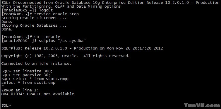

b. service oracle stop
SQL> Disconnected from Oracle Database 10g Enterprise Edition Release 10.2.0.1.0 - ProductionWith the Partitioning, OLAP and Data Mining options[oracle@ORS ~]$ logout[iyunv@ORS ~]# service oracle stopStoping Oracle Listeners ... Done.Stoping Oracle Databases ... Done.[iyunv@ORS ~]# su - oracle[oracle@ORS ~]$ sqlplus "/as sysdba"SQL*Plus: Release 10.2.0.1.0 - Production on Mon Nov 26 20:17:20 2012Copyright (c) 1982, 2005, Oracle.  All rights reserved.Connected to an idle instance.SQL> set linesize 300;SQL> set pagesize 30;SQL> select * from scott.emp;select * from scott.emp*ERROR at line 1:ORA-01034: ORACLE not availableSQL>

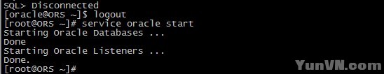

c. service oracle start
SQL> Disconnected[oracle@ORS ~]$ logout[iyunv@ORS ~]# service oracle startStarting Oracle Databases ... DoneStarting Oracle Listeners ... Done.[iyunv@ORS ~]#

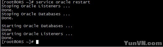

d. service oracle restart
[iyunv@ORS ~]# service oracle restartStoping Oracle Listeners ... Done.Stoping Oracle Databases ... Done.Starting Oracle Databases ... DoneStarting Oracle Listeners ... Done.[iyunv@ORS ~]#
至此,Oracle服务启动&停止脚本与开机自启动设置完毕。
