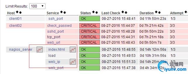

以上只是解决了收集数据的功能,还必须在每一个host、service上展示相应的图形
设置如下:
编辑templates.cfg模板文件,创建host和service支持pnp4nagios功能:
define host {
   name       host-pnp
   action_url /pnp4nagios/index.php/graph?host=$HOSTNAME$&srv=_HOST_
   register   0
define service {
   name       srv-pnp
   action_url /pnp4nagios/index.php/graph?host=$HOSTNAME$&srv=$SERVICEDESC$
   register   0
定义完成之后,最后只需在定义的hosts、services配置文件中加入下操作:
define host{
        use                     linux-server,host-pnp    ; Name of host templates to use
                                                         ; This host definition will inherit all variables that are defined
                                                         ; in (or inherited by) the linux-server host template definition.
        host_name               localhost
        alias                   localhost
        address                 127.0.0.1
define service{
        use                     local-service,srv-pnp   ; Name of service template to use
        host_name               localhost
        service_description     PING
        check_command           check_ping!100.0,20%!500.0,60%
于是整个配置工作完成,访问浏览器出图如下
