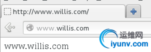

    5.虚拟主机
[iyunv@server1 nginx]# pwd
/opt/lnmp/nginx
[iyunv@server1 nginx]# vim conf/nginx.conf
在http{}中添加
    server {
        listen       80;
        server_name  www.willis.com;
        location / {
            root   /virtual/willis/html;
            index  index.html;
    server {
        listen       80;
        server_name  www.linux.com;
        location / {
            root   /virtual/linux/html;
            index  index.html;
[iyunv@server1 nginx]# mkdir -p /virtual/willis/html
[iyunv@server1 nginx]# mkdir -p /virtual/linux/html
[iyunv@server1 nginx]# echo www.willis.com>/virtual/willis/html/index.html
[iyunv@server1 nginx]# echo www.linux.com>/virtual/linux/html/index.html
[iyunv@server1 nginx]# vim /etc/hosts
    172.25.254.1  www.willis.com
    172.25.254.1  www.linux.com
[iyunv@server1 nginx]# nginx -t
nginx: the configuration file /opt/lnmp/nginx/conf/nginx.conf syntax is ok
nginx: configuration file /opt/lnmp/nginx/conf/nginx.conf test is successful
[iyunv@server1 nginx]# nginx -s reload
测试:
