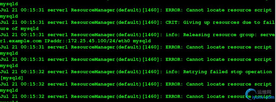

/etc/init.d/heartbeat start
tail -f /var/log/message

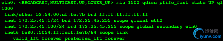

【server1】

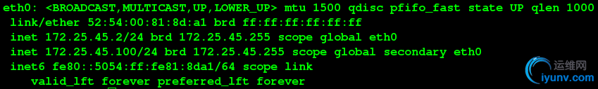

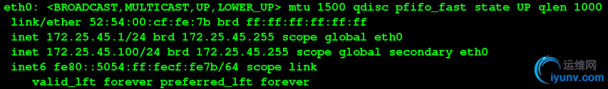

ip addr show

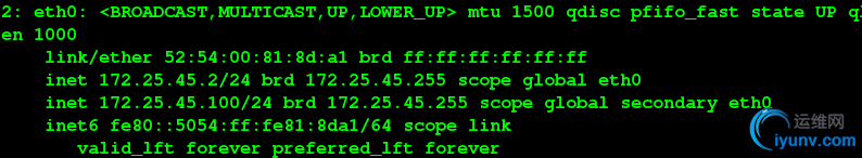

关闭server1的heartbeat的服务,vip切到server2上,但把server1的heartbeat服务打开,vip会切回server1上

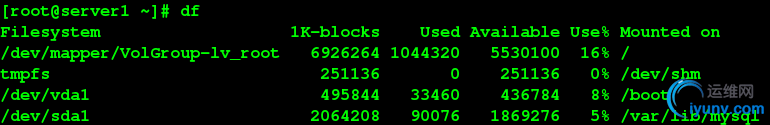

2.
【server1】
vim haresources
修改最后一行的内容为以下:
server1.example.com IPaddr::172.25.45.100/24/eth0 Filesystem::/dev/sda1::/var/lib/mysql::ext4  mysqld
scp haresources  172.25.45.2:/etc/ha.d/
/etc/init.d/mysqld stop
mount /dev/sda1 /mnt
cd /var/lib/mysql/
cp -rp * /mnt/
chown mysql.mysql /mnt/
umount /mnt
/etc/init.d/heartbeat stop
/etc/init.d/heartbeat start    ##在server2上

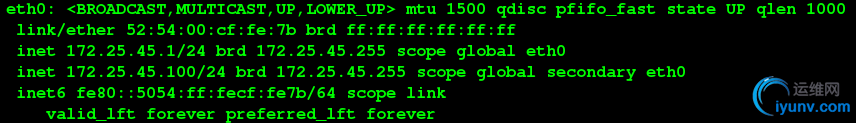

ip addr show
ip addr show    ##在server2上
将server1上的heartbeat服务再次打开,则server2上的vip和挂载都会切回server1

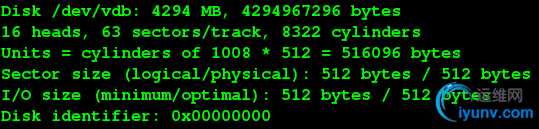

为server1和server2都添加一个4G的虚拟硬盘
【server1/server2】
/etc/init.d/iscsi stop
fdisk -l

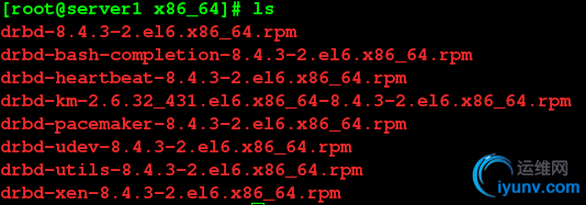

rpmbuild -bb drbd.spec
rpmbuild -bb drbd-km.spec    ##解决依赖性: yum install -y kernel-devel
cd /root/rpmbuild/RPMS/x86_64
ls
rpm -ivh *
scp * 172.25.45.2:

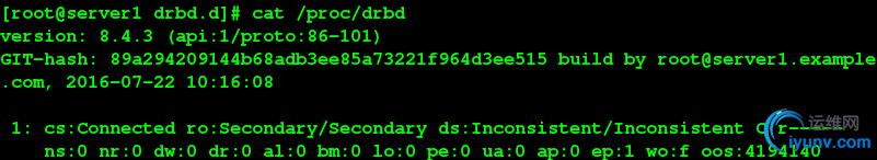

drbdadm create-md sqldata
/etc/init.d/drbd start
【server1】

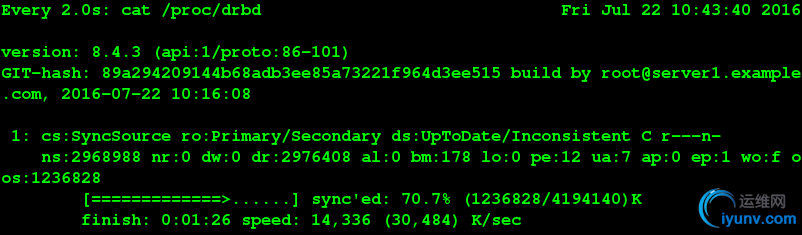

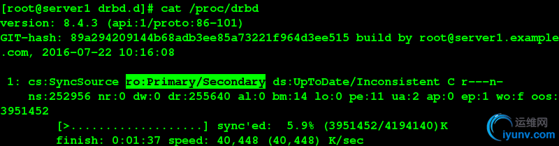

cat /proc/drbd
drbdadm primary sqldata --force
cat /proc/drbd

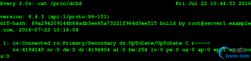

watch cat /proc/drbd

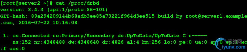

cat /proc/drbd

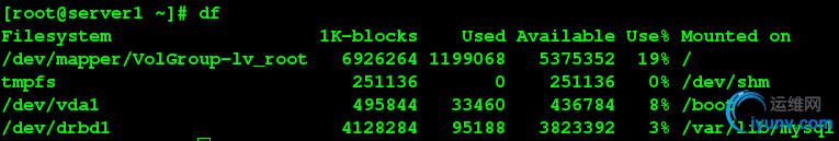

【server1】
vim /etc/ha.d/haresources
修改内容为以下:

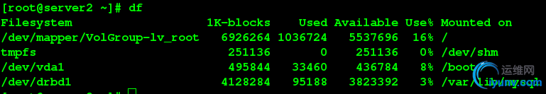

server1.example.com IPaddr::172.25.45.100/24/eth0 drbddisk::sqldata  Filesystem::/dev/drbd1::/var/lib/mysql::ext4  mysqld
scp /etc/ha.d/haresources 172.25.45.2:/etc/ha.d/
cat /proc/drbd    ##此时ro:Secondary/Secondary
tail -f /var/log/messages
【server2】

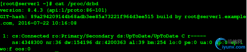

【server1】
cat /proc/drbd

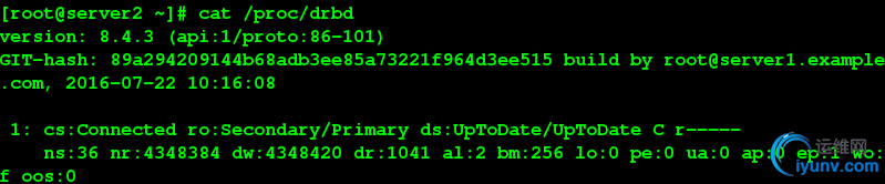

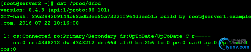

【server2】
cat /proc/drbd
