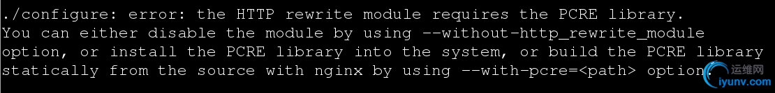

[iyunv@server1 nginx-1.10.1]# ./configure--prefix=/usr/local/lnmp/nginx --with-http_ssl_module--with-http_stub_status_module
如果出现以下错误
[iyunv@server1 nginx-1.10.1]# yum install pcre-devel -y
重新配置

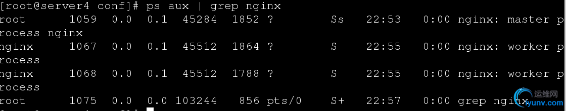

[iyunv@server1 conf]# nginx -t   #检测
nginx: the configuration file/usr/local/lnmp/nginx/conf/nginx.conf syntax is ok
nginx: configuration file /usr/local/lnmp/nginx/conf/nginx.conftest is successful
[iyunv@server1 conf]# nginx -s reload   #重载
测试
[iyunv@server1 conf]# ps aux | grep nginx
