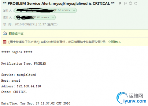

七.实战手动添加主机,监控mysql
7.1添加mysql主机
define host{   ;定义一个客户主机(可以定义很多个)
        uselinux-server,host-pnp   ;使用的模板
       host_name mysql  ;主机名
        aliasmysql  ;主机别名
        address192.168.44.110  ;主机IP
#以下是正在获取

7.2在客户端添加脚本
10
11
12
13
14
15
16
17
18
19
root@mysql02 /usr/local/nagios/libexec 10:11:47 # ./check_mysql
mysql is up
root@mysql02 /usr/local/nagios/libexec 10:11:48 #chmod 755 check_mysql
root@mysql02 /usr/local/nagios/libexec 10:12:01 # catcheck_mysql
#!/bin/bash
mysqladmin ping > /dev/null 2>&1
if [ $? -eq 0 ]; then
        echo"mysql is up"
        exit 0
else
        echo"mysql is down"
        exit 2
fi
root@mysql02 /usr/local/nagios/libexec 10:12:06 # ./check_mysql
mysql is up
root@mysql02 /usr/local/nagios/libexec 10:12:08 # service mysqld stop
Shutting down MySQL............ SUCCESS!
root@mysql02 /usr/local/nagios/libexec 10:12:40 # ./check_mysql
mysql is down

7.7.6停止mysql服务测试报警
#页面显示mysqldown
#收到报警邮件
#启动mysql后收到恢复邮件
