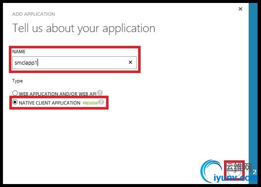

    d.Enter the name of the application, select NATIVE CLIENT APPLICATION, and then click the right arrow.
    e.Enter a URI for the application and then click the checkmark. The URI includes the name of the application that is preceded by http://localhost/.

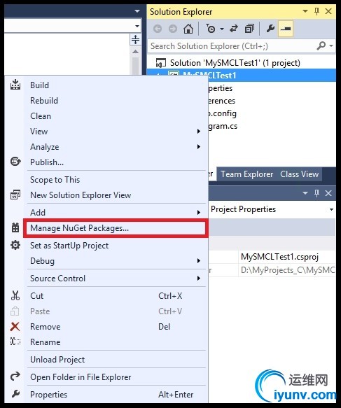

    You can easily install the Active Directory Authentication Library into your Visual Studio project by using the NuGet package. To install the package, do the following:
    1.Right-click the project name in the Solution Explorer, and then click Manage NuGet Packages.
    2.Type Active Directory in the search box, click Install for the Active Directory Authentication Library package, and then follow the instructions to install the package.

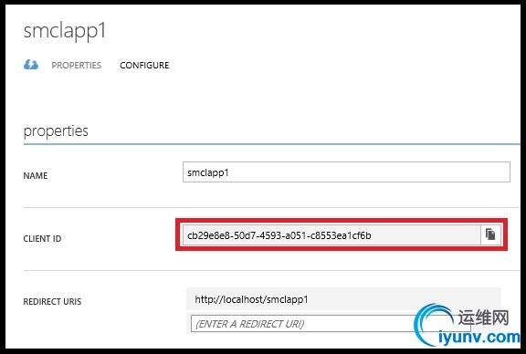

{tenantId} with the GUID of the application. To find the GUID, go to the Default Directory page in the Active Directory section of the Management Portal, select the application that you previously created, and then click View Endpoints.
    4.Copy the GUID of the application and replace the placeholder with it.
    {clientId} with the client identifier. To find the client identifier, go to the Configuration page of the application in the Management Portal.
