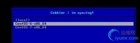

13、导入镜像
挂载centos光盘镜像
[iyunv@cobbler scripts]# mount /dev/cdrom /mnt
mount: block device /dev/sr0 is write-protected, mounting read-only
[iyunv@cobbler scripts]# df -h
Filesystem      Size  Used Avail Use% Mounted on
/dev/sda2        19G  1.6G   17G   9% /
tmpfs           491M     0  491M   0% /dev/shm
/dev/sda1       190M   33M  147M  19% /boot
/dev/sr0        3.7G  3.7G     0 100% /mnt
导入镜像
10
11
12
13
14
15
16
17
18
19
[iyunv@cobbler scripts]# cobbler import --path=/mnt/ --name=CentOS-6-x86_64 --arch=x86_64

# --path 镜像路径
# --name 为安装源定义一个名字
# --arch 指定安装源是32位、64位、ia64, 目前支持的选项有: x86│x86_64│ia64
# 安装源的唯一标示就是根据name参数来定义,本例导入成功后,安装源的唯一标示就是:CentOS-6.6-x86_64,如果重复,系统会提示导入失败。
查看导入镜像
[iyunv@cobbler scripts]# cobbler distro list
   CentOS-6-x86_64
同上例,我把CentOS-7-x86_64也导入
镜像存放目录,cobbler会将镜像中的所有安装文件拷贝到本地一份,放在/var/www/cobbler/ks_mirror下的CentOS-6.6-x86_64目录下。因此/var/www/cobbler目录必须具有足够容纳安装文件的空间
[iyunv@cobbler scripts]# cd /var/www/cobbler/ks_mirror/
[iyunv@cobbler ks_mirror]# ls
CentOS-6-x86_64  CentOS-7-x86_64  config
[iyunv@cobbler ks_mirror]# ls CentOS-6-x86_64/
CentOS_BuildTag  GPL       Packages                  RPM-GPG-KEY-CentOS-6           RPM-GPG-KEY-CentOS-Testing-6
EFI              images    RELEASE-NOTES-en-US.html  RPM-GPG-KEY-CentOS-Debug-6     TRANS.TBL
EULA             isolinux  repodata                  RPM-GPG-KEY-CentOS-Security-6

自定义ks.cfg文件
[iyunv@cobbler kickstarts]# cobbler profile edit --name=CentOS-6-x86_64 --kickstart=/var/lib/cobbler/kickstarts/CentOS-6-x86_64.cfg
修改内核参数
[iyunv@cobbler kickstarts]# cobbler profile edit --name=CentOS-6-x86_64 --kopts='net.ifnames=0 biosdevname=0'
查看所有的profile设置

15、修改这里,开机画面显示
[iyunv@cobbler kickstarts]# vim /etc/cobbler/pxe/pxedefault.template
DEFAULT menu
PROMPT 0
MENU TITLE Cobbler | im syaving!
TIMEOUT 200
TOTALTIMEOUT 6000
ONTIMEOUT $pxe_timeout_profile
QQ截图20161021081959.png 修改完毕后记着同步
