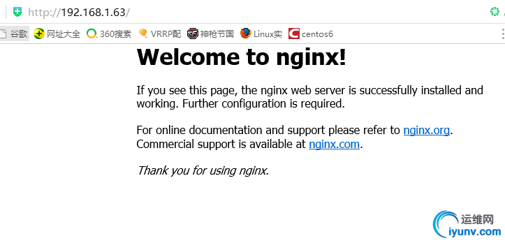

[iyunv@xuegod63 nginx-1.2.8]#  ./configure --prefix=/server/nginx-1.2.8 --with-http_dav_module --with-http_stub_status_module --with-http_addition_module --with-http_sub_module --with-http_flv_module --with-http_mp4_module

5)启动nginx:
[iyunv@xuegod63 nginx-1.2.8]# /server/nginx-1.2.8/sbin/nginx #启动
6)开机启动:
[iyunv@xuegod63 nginx-1.2.8]# echo '/server/nginx-1.2.8/sbin/nginx & ' >> /etc/rc.local
7)测试配置文件是否正确:
[iyunv@xuegod63 nginx-1.2.8]# /server/nginx-1.2.8/sbin/nginx -t
nginx: the configuration file /server/nginx-1.2.8/conf/nginx.conf syntax is ok
nginx: configuration file /server/nginx-1.2.8/conf/nginx.conf test is successful
8)重新加载配置文件
[iyunv@xuegod63 nginx-1.2.8]# /server/nginx-1.2.8/sbin/nginx -s reload

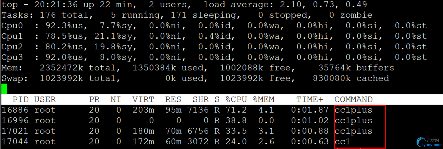

  在编译时,查看CPU使用情况:
top-》P  查看CPU使用情况:
wKioL1gj1hSA2P1jAAdnwBhRxc4625.jpg cc1plus   #cc1plus是C++编译器程序,用于该软件对C++程序的编译功能。
