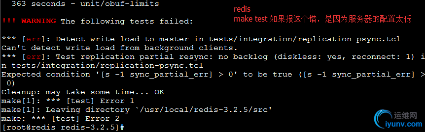

[iyunv@redis redis-3.2.5]# make test

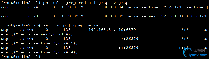

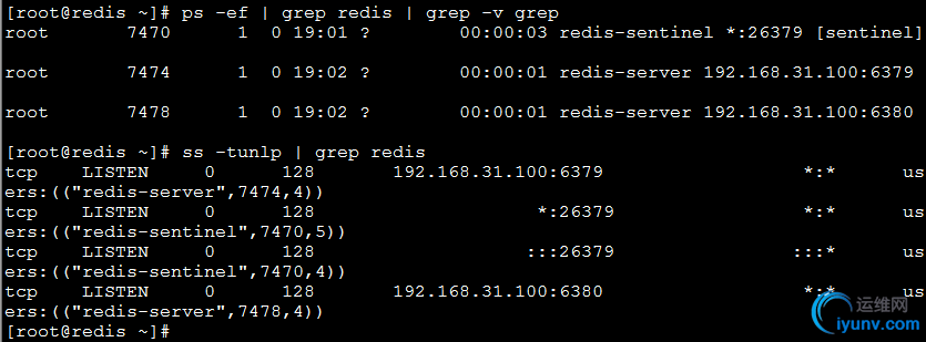

注:要先启动所以的sentinel再逐一启动各个redis:
10
[iyunv@redis ~]# redis-sentinel /usr/local/redis-sentinel/etc/sentinel.conf
[iyunv@redis2 ~]# redis-sentinel /usr/local/redis-sentinel/etc/sentinel.conf
[iyunv@redis ~]# redis-server /usr/local/redis-3.2.5/redis_6379.conf
[iyunv@redis ~]# redis-server /usr/local/redis-3.2.5/redis_6380.conf
[iyunv@redis2 ~]# redis-server /usr/local/redis-3.2.5/redis.conf
[iyunv@redis ~]# echo "redis-sentinel /usr/local/redis-sentinel/etc/sentinel.conf" >> /etc/rc.local
[iyunv@redis ~]# echo "redis-server /usr/local/redis-3.2.5/redis_6379.conf" >> /etc/rc.local
[iyunv@redis ~]# echo "redis-server /usr/local/redis-3.2.5/redis_6380.conf" >> /etc/rc.local
[iyunv@redis2 ~]# echo "redis-sentinel /usr/local/redis-sentinel/etc/sentinel.conf" >> /etc/rc.local
[iyunv@redis2 ~]# echo "redis-server /usr/local/redis-3.2.5/redis.conf" >> /etc/rc.local

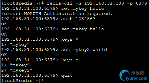

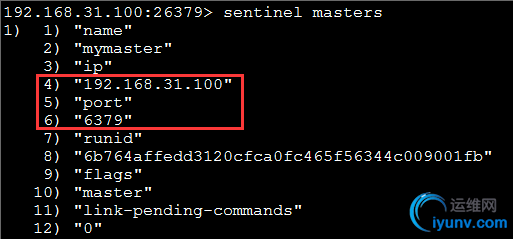

主节点测试写入数据:

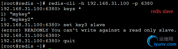

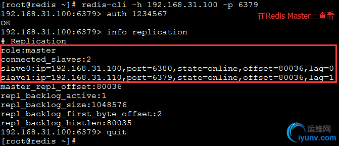

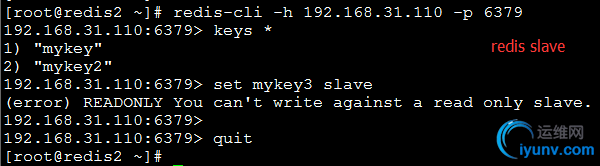

在redis slave上查看数据同步情况,slave是不能写入数据的:
成功。

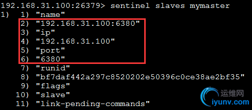

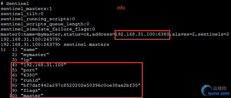

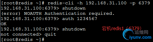

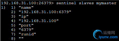

测试redis Master宕机后,哨兵是否能正常切换:
[iyunv@redis ~]# /usr/local/redis-sentinel/bin/redis-cli -h 127.0.0.1 -p 26379
127.0.0.1:26379> info

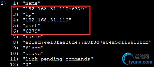

OK,切换成功,之前的Master变成slave,其中一个slave变成Master

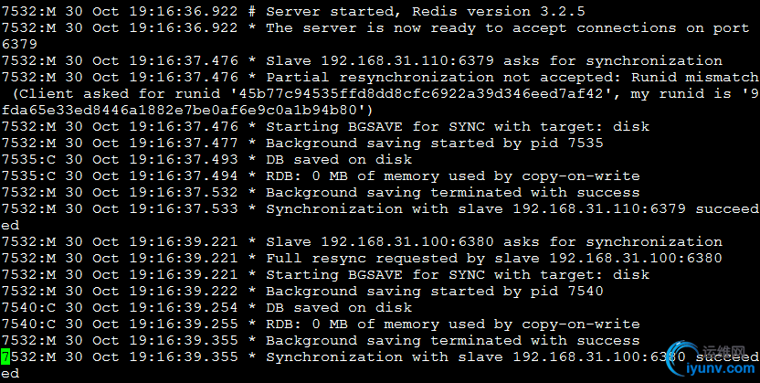

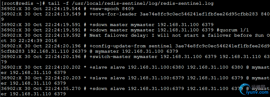

Sentinel日志:
重新启动之前宕机的redis1,日志显示其启动切换角色为slave
