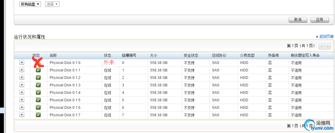

Idrac监控报错:登陆ideac卡后如下如所示:硬盘状态是红叉,状态是外来
wKiom1g1a1zD5MxEAADsDNwti64997.jpg 命令行安装MegaCli

执行导入命令
/opt/MegaRAID/MegaCli/MegaCli64  -CfgForeign -Import -aall
Foreign configuration is imported on controller 0.
Exit Code: 0x00
再次执行状态检测命令:
/opt/MegaRAID/MegaCli/MegaCli64 -pdlist -aall |grep 'Firmware state'
Firmware state: Rebuild
Firmware state: Online, Spun Up
