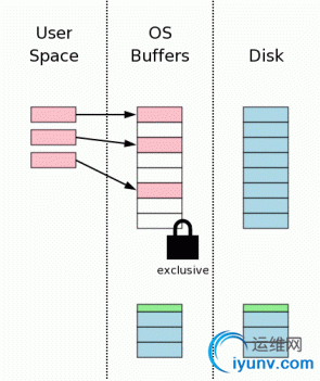

  9、
修改的页面写入文件(Writing Changes To The Database File)
一旦得到
exclusive
lock,其它的进程就不能进行读操作,此时就可以把修改的页面写回数据库文件,但是通常OS都把结果暂时保存到磁盘缓存中,直到某个时刻才会真正把结果
写入磁盘。

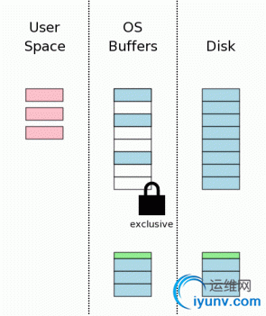

  10、
修改结果刷入存储设备(Flushing Changes To Mass Storage)
为了保证修改结果真正
写入磁盘,这一步必不要少。对于数据库存的完整性,这一步也是关键的一步。由于要进行实际的I/O操作,所以和第7步一样,将花费较多的时间。

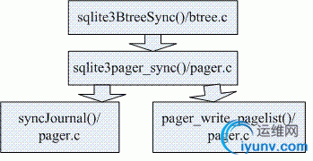

  最后来看看这几步是如何实现的:
  其实以上以上几步是在函数
sqlite3BtreeSync
()---btree.c中
调用的(而关于该函数的调用后面再讲)。
  代码如下:
DSC0005.gif //同步btree对应的数据库文件
//该函数返回之后,只需要提交写事务,删除日志文件
int sqlite3BtreeSync(Btree *p, const char *zMaster){
int rc = SQLITE_OK;
if( p->inTrans==TRANS_WRITE ){
BtShared *pBt = p->pBt;
Pgno nTrunc = 0;
#ifndef SQLITE_OMIT_AUTOVACUUM
if( pBt->autoVacuum ){
rc = autoVacuumCommit(pBt, &nTrunc);
if( rc!=SQLITE_OK ){
return rc;
#endif
//调用pager进行sync
rc = sqlite3pager_sync(pBt->pPager, zMaster, nTrunc);
return rc;
//把pager所有脏页面写回文件
int sqlite3pager_sync(Pager *pPager, const char *zMaster, Pgno nTrunc){
int rc = SQLITE_OK;
TRACE4("DATABASE SYNC: File=%s zMaster=%s nTrunc=%d\n",
pPager->zFilename, zMaster, nTrunc);
/* If this is an in-memory db, or no pages have been written to, or this
** function has already been called, it is a no-op.
//pager不处于PAGER_SYNCED状态,dirtyCache为1,
//则进行sync操作
if( pPager->state!=PAGER_SYNCED && !MEMDB && pPager->dirtyCache ){
PgHdr *pPg;
assert( pPager->journalOpen );
/* If a master journal file name has already been written to the
** journal file, then no sync is required. This happens when it is
** written, then the process fails to upgrade from a RESERVED to an
** EXCLUSIVE lock. The next time the process tries to commit the
** transaction the m-j name will have already been written.
if( !pPager->setMaster ){
//pager修改计数
rc = pager_incr_changecounter(pPager);
if( rc!=SQLITE_OK ) goto sync_exit;
if( nTrunc!=0 ){
/* If this transaction has made the database smaller, then all pages
** being discarded by the truncation must be written to the journal
** file.
Pgno i;
void *pPage;
int iSkip = PAGER_MJ_PGNO(pPager);
for( i=nTrunc+1; i<=pPager->origDbSize; i++ ){
if( !(pPager->aInJournal[i/8] & (1<<(i&7))) && i!=iSkip ){
rc = sqlite3pager_get(pPager, i, &pPage);
rc = sqlite3pager_write(pPage);
sqlite3pager_unref(pPage);
#endif
rc = writeMasterJournal(pPager, zMaster);
//sync日志文件
rc = syncJournal(pPager);
if( nTrunc!=0 ){
rc = sqlite3pager_truncate(pPager, nTrunc);
#endif
/* Write all dirty pages to the database file */
pPg = pager_get_all_dirty_pages(pPager);
//把所有脏页面写回操作系统文件
rc = pager_write_pagelist(pPg);
/* Sync the database file. */
//sync数据库文件
if( !pPager->noSync ){
rc = sqlite3OsSync(pPager->fd, 0);
pPager->state = PAGER_SYNCED;
}else if( MEMDB && nTrunc!=0 ){
sync_exit:
return rc;
  下图可以进一步解释该过程:
