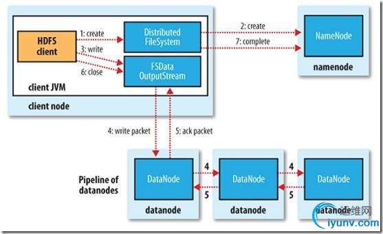

1.2.2.Anatomy of a File Write
  lThe client creates the file by calling create() (step 1).
  lDistributedFileSystem makes an RPC call to the namenode to create a new file in the filesystem’s namespace, with no blocks associated with it (step 2).
  lThe namenode performs various checks to make sure the file doesn’t already exist, and that the client has the right permissions to create the file. If these checks pass, the namenode makes a record of the new file; otherwise, file creation failsand the client is thrown an IOException.
  lThe DistributedFileSystem returns a FSDataOutputStream for the client to start writing data to.
  lAs the client writes data (step 3), DFSOutputStream splits it into packets, which it writes to an internal queue, called the data queue.
  lThe data queue is consumed by the Data Streamer, whose responsibility it is to ask the namenode to allocate new blocks by picking a list of suitable datanodes to store the replicas. The list of datanodes forms apipeline.
  lThe DataStreamer streams the packets to the first datanode in the pipeline, which storesthe packet and forwards it to the second datanode in the pipeline. Similarly, the seconddatanode stores the packet and forwards it to the third (and last)datanode in the pipe line (step 4).
  lDFSOutputStream also maintains an internal queue of packets that are waiting to be acknowledged by datanodes, called the ack queue. A packet is removed from the ack queue only when it has been acknowledged by all the datanodes in the pipeline (step5).
  lIf a datanode fails while data is being written to it,
  nFirst the pipeline is closed, and any packets in the ack queue are added to the front of the data queue.
  nThe current block on the good datanodes is given a new identity by the namenode, so that the partial block on the failed datanode will be deleted if the failed data node recovers later on.
  nThe failed datanode is removed from the pipeline and the remainder of the block’s data is written to the two good datanodes in the pipeline.
  nThe namenode notices that the block is under-replicated, and it arranges for a further replica to be created on another node.
  lWhen the client has finished writing data it calls close() on the stream (step 6). This action flushes all the remaining packets to the datanode pipeline and waits for acknowledgments before contacting the namenode to signal that the file is complete(step7).

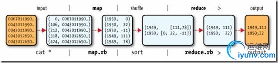

2.Meet Map/Reduce
  lMapReduce has two phases: the map phase and the reduce phase.
  lEach phase has key-value pairs as input and output (the types can be specified).
  nThe input key-value types of the map phase is determined by the input format
  nThe output key-value types of the map phase should match the input key value types of the reduce phase
  nThe output key-value types of the reduce phase can be set in the JobConf interface.
  lThe programmer specifies two functions: the map function and the reduce function.
2.1.MapReduce logical data flow

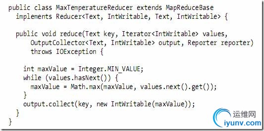

2.2.2.The reduce function is defined using a Reducer
  lThe input types of the reduce function must match the output type of the map function.

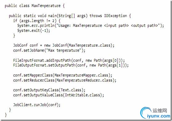

2.2.3.The code runs the MapReduce job
  lAn input path is specified by calling the static addInputPath() method on FileInputFormat
  nIt can be a single file, a directory, or a file pattern.
  naddInputPath() can be called more than once to use input from multiple paths.
  lThe output path is specified by the static setOutputPath() method on FileOutputFormat.
  nIt specifies a directory where the output files from the reducer functions are written.
  nThe directory shouldn’t exist before running the job
  lThe map and reduce types can be specified via the setMapperClass() and setReducerClass() methods.
  lThe setOutputKeyClass() and setOutputValueClass() methods control the output types for the map and the reduce functions, which are often the same.
  nIf they are different, then the map output types can be set using the methods setMapOutputKeyClass() and setMapOutputValueClass().
  lThe input types are controlled via the input format, which we have not explicitly set since we are using the default TextInputFormat.

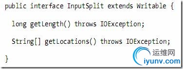

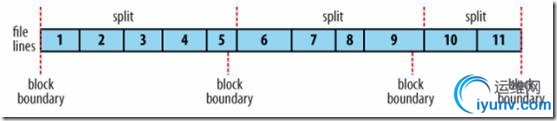

  lHadoop divides the input to a MapReduce job into fixed-size input splits.
  lHadoop creates one map task for each split, which runs the user defined map function for each record in the split.
  lHadoop does its best to run the map task on a node where the input data resides in HDFS.
  nThis is called the data locality optimization.
  nThis is why the optimal split size is the same as the block size: it is the largest size of input that can be guaranteed to be stored on a single node.

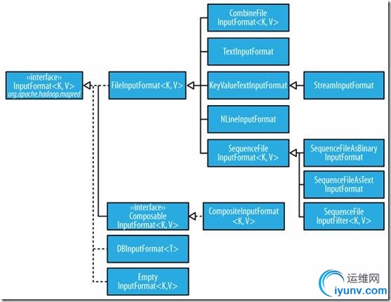

  lInput types are set by the input format.
  nFor instance, a TextInputFormat generates keys of type LongWritable and values of type Text.
  lA minimal MapReduce driver, with the defaults explicitly set
  lThe default input format is TextInputFormat, which produces keys of type LongWritable (the offset of the beginning of the line in the file) and values of type Text (the line of text).

  lAn input split is a chunk of the input that is processed by a single map.
  lEach split is divided into records, and the map processes each record—a key-value pair—in turn.
  lAn InputSplit has a length in bytes, and a set of storage locations, which are just hostname strings.
  lA split doesn’t contain the input data; it is just a reference to the data.
  lThe storage locations are used by the MapReduce system to place map tasks as close to the split’s data as possible
  lThe size is used to order the splits so that the largest get processed first

  lFileInputFormat is the base class for all implementations of InputFormat that use files as their data source.
  lIt provides two things: a place to define which files are included as the input to a job, and an implementation for generating splits for the input files.
  lFileInputFormat input paths may represent a file, a directory, or, by using a glob, a collection of files and directories.
  lTo exclude certain files from the input, you can set a filter using the setInputPathFilter() method on FileInputFormat
  lFileInputFormat splits only large files. Here “large” means larger than an HDFS block.

  lTextInputFormat is the default InputFormat.
  nEach record is a line of input.
  nThe key, a LongWritable, is the byte offset within the file of the beginning of the line.
  nThe value is the contents of the line, excluding any line terminators, and is packaged as a Text object.
  lThe logical records that FileInputFormats define do not usually fit neatly into HDFS blocks.
  lA single file is broken into lines, and the line boundaries do not correspond with the HDFS block boundaries.
  lSplits honor logical record boundaries
  nThe first split contains line 5, even though it spans the first and second block.
  nThe second split starts at line 6.
  lData-local maps will perform some remote reads.

  lIt is common for each line in a file to be a key-value pair, separated by a delimiter such as a tab character.
  lYou can specify the separator via the key.value.separator.in.input.line property.
NLineInputFormat
  lIf you want your mappers to receive a fixed number of lines of input, then NLineInputFormat is the InputFormat to use.
  lLike TextInputFormat, the keys are the byte offsets within the file and the values are the lines themselves.
  lN refers to the number of lines of input that each mapper receives.
3.2.4.Binary Input
SequenceFileInputFormat
  lHadoop’s sequence file format stores sequences of binary key-value pairs.
  lTo use data from sequence files as the input to MapReduce, you use SequenceFileInputFormat.
  lThe keys and values are determined by the sequence file, and you need to make sure that your map input types correspond.
  lFor example, if your sequence file has IntWritable keys and Text values, then the map signature would be Mapper<IntWritable, Text, K, V>.

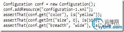

  lAn instance of the Configuration class (found in the org.apache.hadoop.conf package) represents a collection of configuration properties and their values.
  lConfigurations read their properties from resources—XML files
  lwe can access its properties using a piece of code like this:
