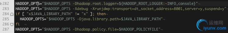

4. Go to Hadoop’s directory, and copy file bin/hadoop to bin/hdebug
5. Now, we need to make Hadoop start in debug mode. What you should do is to add one line of text into the starting script:
Yes, here’s it. Copy it from here:
-Xdebug -Xrunjdwp:transport=dt_socket,address=8001,server=y,suspend=y
What does it say basically is an instruction to Java to start in debug mode, and wait for socket connection of the remote debugger on port 8001; execution should be suspended after the start until debugger is connected.
Now, go and start your grid application like you did in step 3, but now use bin/hdebug script we’ve created. If you’ve done everything correctly, program should output something like this:
Listening for transport dt_socket at address: 8001
