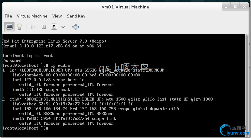

先截图上一篇装完rhel系统的样子:
回归到正文,今天讲HTTPD+FTP+KickStart发布镜像。

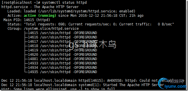

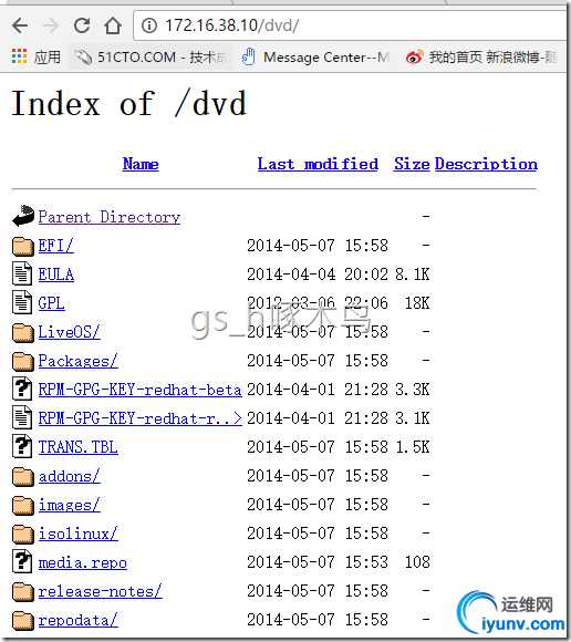

1.先安装httpd服务,由于我们上一篇已安装,我们先确保httpd服务能正常启动,并测试web服务器的dvd目录是否正常访问;
[iyunv@localhost ~]# systemctl status httpd   #查看HTPPD服务状态
httpd.service - The Apache HTTP Server
   Loaded: loaded (/usr/lib/systemd/system/httpd.service; enabled)
   Active: active (running) since Mon 2016-12-12 21:56:18 CST; 21h ago
Main PID: 14615 (httpd)
   Status: "Total requests: 698; Current requests/sec: 0; Current traffic:   0 B/sec"
   CGroup: /system.slice/httpd.service
           ├─14615 /usr/sbin/httpd -DFOREGROUND
           ├─14616 /usr/sbin/httpd -DFOREGROUND
           ├─14617 /usr/sbin/httpd -DFOREGROUND
           ├─14618 /usr/sbin/httpd -DFOREGROUND
           ├─14619 /usr/sbin/httpd -DFOREGROUND
           ├─14620 /usr/sbin/httpd -DFOREGROUND
           ├─14881 /usr/sbin/httpd -DFOREGROUND
           ├─14933 /usr/sbin/httpd -DFOREGROUND
           ├─14934 /usr/sbin/httpd -DFOREGROUND
           └─14935 /usr/sbin/httpd -DFOREGROUND
Dec 12 21:56:18 localhost.localdomain httpd[14615]: AH00558: httpd: Could not reliably...e
Dec 12 21:56:18 localhost.localdomain systemd[1]: Started The Apache HTTP Server.
Hint: Some lines were ellipsized, use -l to show in full.
别记错哦,这里是对外的ip地址,不是对内的vnet ip地址;

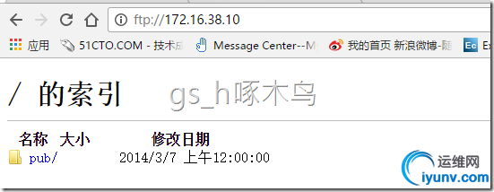

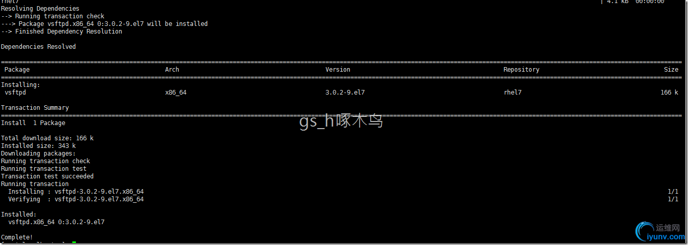

2.安装FTP服务;
[iyunv@localhost ~]# yum install vsftpd -y  #安装vsftpd服务

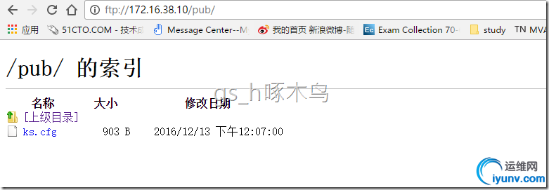

3.启动vsftpd服务,启用vsftpd服务,测试ftp是否可以正常访问;

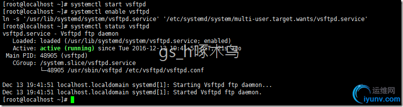

[iyunv@localhost ~]# systemctl start vsftpd   #启动vsftpd服务
[iyunv@localhost ~]# systemctl enable vsftpd    #启用vsftpd服务
ln -s '/usr/lib/systemd/system/vsftpd.service' '/etc/systemd/system/multi-user.target.wants/vsftpd.service'
[iyunv@localhost ~]# systemctl status vsftpd
vsftpd.service - Vsftpd ftp daemon
   Loaded: loaded (/usr/lib/systemd/system/vsftpd.service; enabled)
   Active: active (running) since Tue 2016-12-13 19:41:51 CST; 21s ago
Main PID: 48905 (vsftpd)
   CGroup: /system.slice/vsftpd.service
           └─48905 /usr/sbin/vsftpd /etc/vsftpd/vsftpd.conf
Dec 13 19:41:51 localhost.localdomain systemd[1]: Starting Vsftpd ftp daemon...
Dec 13 19:41:51 localhost.localdomain systemd[1]: Started Vsftpd ftp daemon.

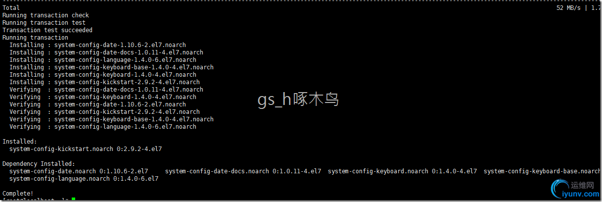

4.安装KickStart服务;
[iyunv@localhost ~]# yum install system-config-k    #安装KickStart服务

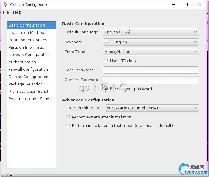

[iyunv@localhost ~]# system-config-kickstart &   #启动kickstart控制面板

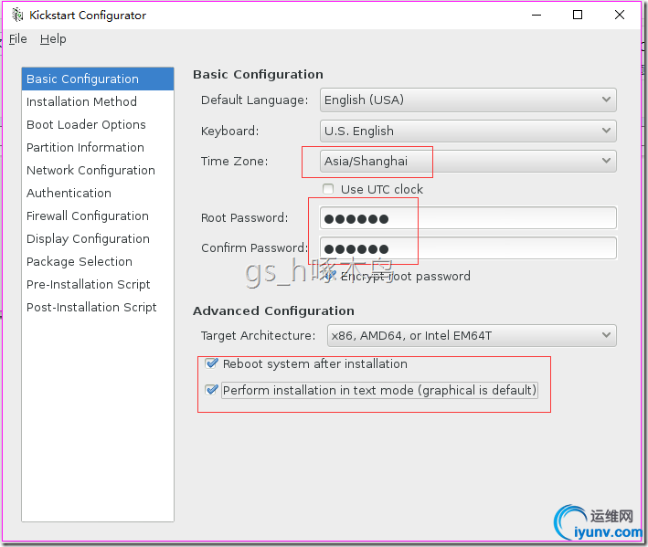

6.在Kickstart Configurator-Basic Configuration界面,配置Time Zone时间为Asia/Shanghai,输入Root Passowrd,勾选Reboot system after installation和Perform installation in text mode(grahical is default);

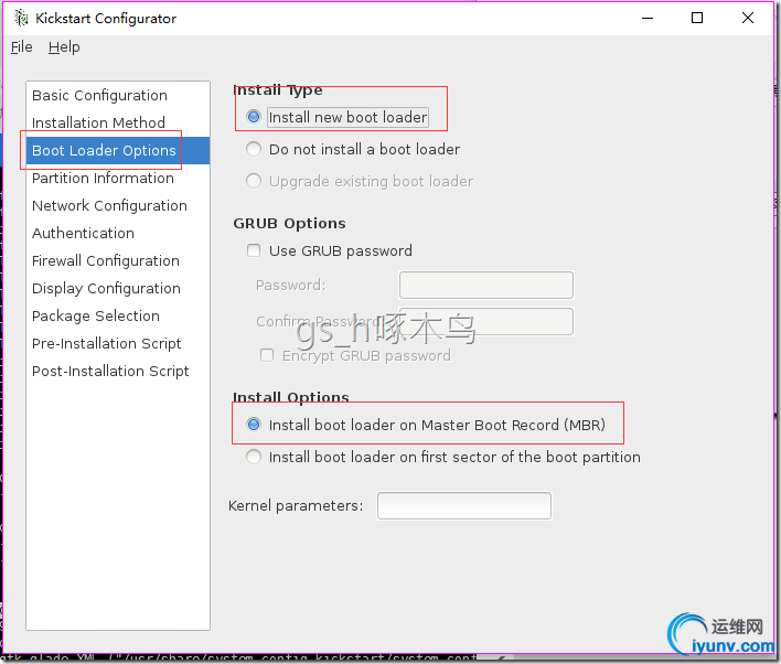

8.在Kickstart Configurator-Boot Loader Options,勾选install new boot loader,勾选Install boot loader on Master Boot Record(MBR);

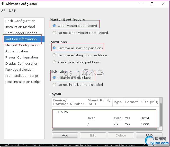

9.在Kickstart Configurator-Partition Information,勾选Clear Master Boot Record,勾选Remove all existing partitions,勾选Initialize the disk label,Add swap和/分区,并分配空间;

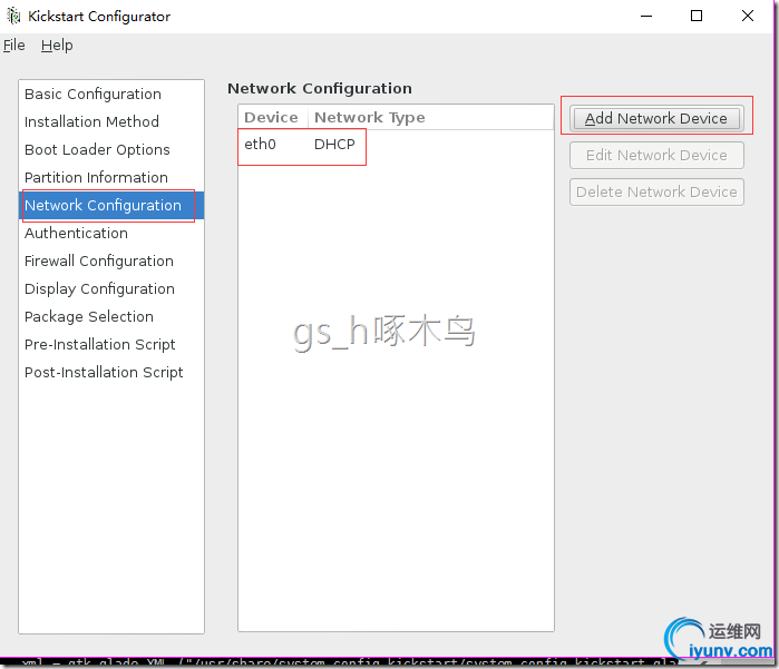

10.在Kickstart Configurator-Network Configuration,点击Add Network Device,输入Network Device名,配置Network Type为DHCP;

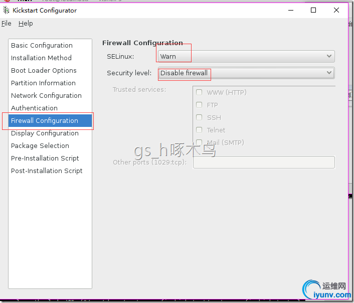

11.在Kickstart Configurator-Firewall Configuration,配置SELinux为Warn,配置Security level为Disable firewall;

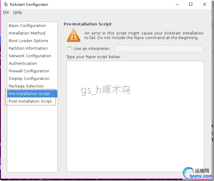

12.其他部分保持默认,如果你要添加shell,可以在Pre-Installation Script或者Post-Installation Script添加对应的shell脚本

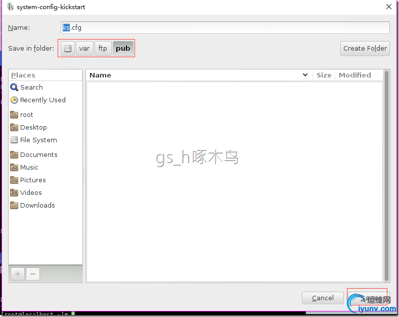

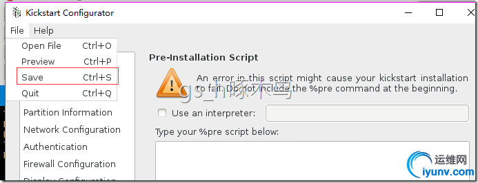

13.点击File-Save;
14.因为我们之前搭建vsftp服务,我们直接存放在/var/ftp/pub里面;
15.补充一点,Package Selection默认在Kickstart配置器是不能勾选的;

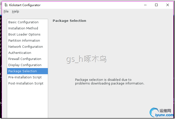

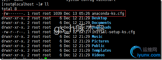

16.我们可以通过在/root目录有个anaconda-ks.cfg,这个也是Kickstart配置文件,进行将Package Selection的部分内容复制到我们刚才制作的ks.cfg配置文件中;
[iyunv@localhost ~]# ll    #查看/root目录下的文件和目录信息

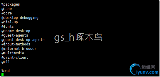

我们将这部分复制出来,张贴到ks.cfg配置文件;
[iyunv@localhost ~]# vim /var/ftp/pub/ks.cfg    #编辑ks.cfg配置文件

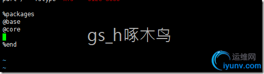

%packages
@base
@core
%end
在这里的意思,就是最小安装模式;
然后我们保存并退出;

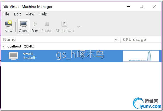

[iyunv@localhost ~]# virt-manager    #启动virt-manager界面

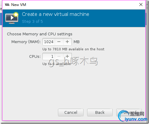

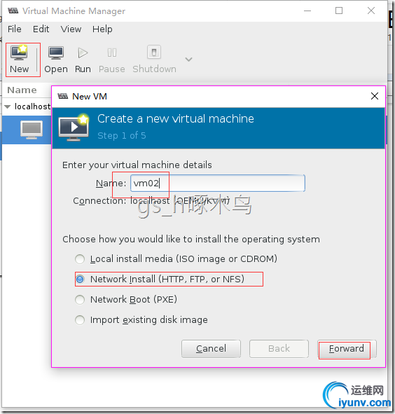

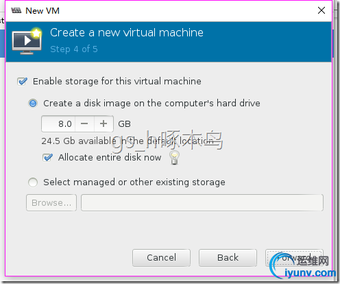

18.在Virtual Machine Manager,点击New,输入Name,勾选Network Install(HTTP,FTP,or NFS),点击Forward;

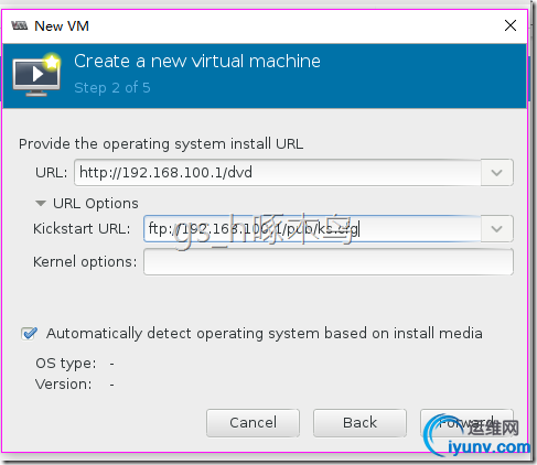

19.在New VM第二部,输入URL:http://192.168.100.1/dvd,配置KickStart URL:ftp://192.168.100.1/pub/ks.cfg,点击Forward;
20.在New VM第三步,点击Forward;
21.在New VM第四步,点击Forward;

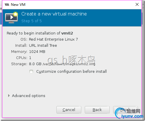

22.在New VM第五步,点击Finish;

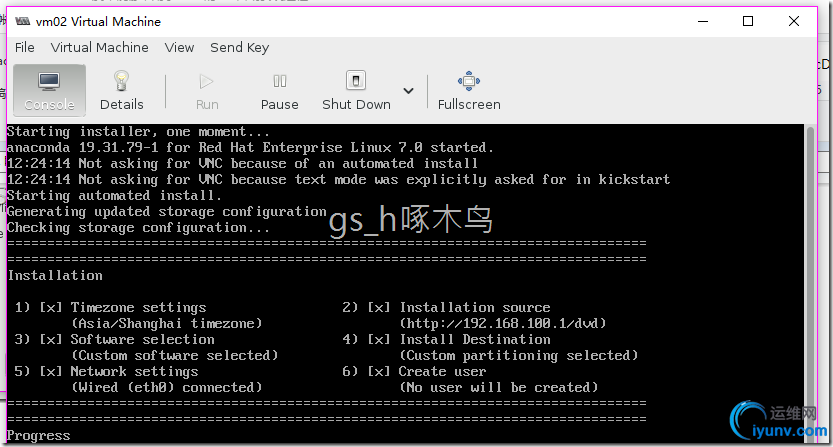

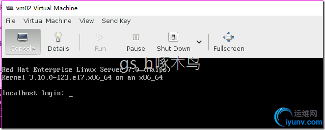

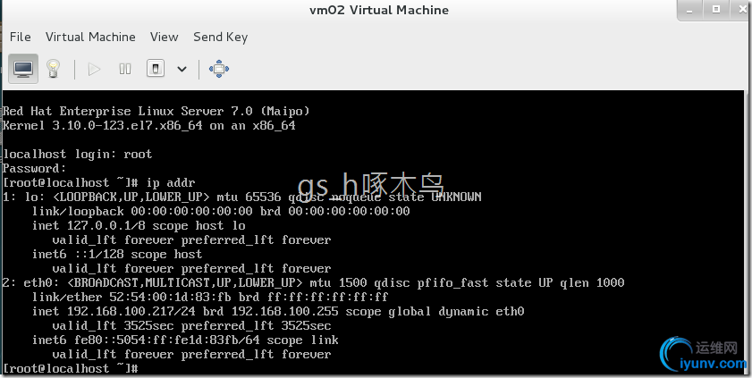

23.看到这个界面,表示KickStart配置文件没问题,可以自动化安装vm;
