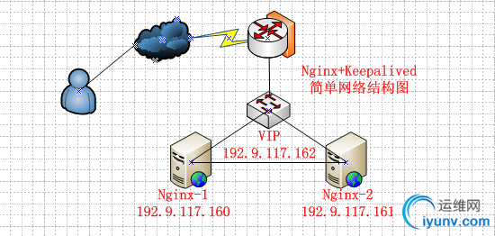

一、实验环境:
系统环境:CentOS 6.0 x86_64
Nginx版本:nginx v1.2.4
Keepalived版本:keepalived v1.2.1
Nginx-1:192.9.117.160 (Master)
Nginx-2:192.9.117.161 (Backup)

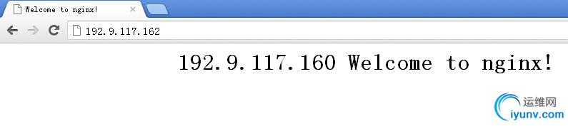

访问VIP http://192.9.117.162 如下:
