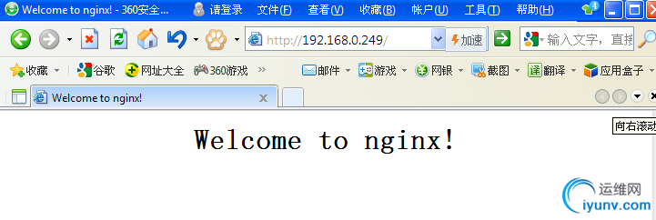

6)  启动并测试
键入命令
#/usr/local/nginx/sbin/nginx
[emerg]: bind() to 0.0.0.0:80 failed (98: Address already in use)
[emerg]: still could not bind()
出现这些东西,说明服务已经启动。
然后在ie中访问你虚拟机的ip,出现这个就安装成功了!
