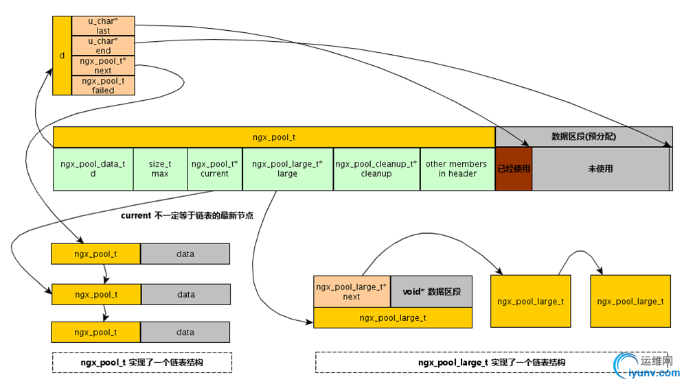

2.   nginx内存池
  为了方便系统模块对内存的使用,方便内存的管理,nginx自己是信了进程池机制来进行内存的分配和释放,首先nginx会在特定的生命周期帮你统一建立内存池,当需要进行内存分配的时候同一通过内存池中的内存进行分配,最后nginx会在适当的时候释放内存吃的资源,开发者只要在需要的时候对内存进行申请即可,不用过多考虑释放的问题,这也就是在os/unix/ngx_alloc.c文件中没有看到free操作的原因吧。
下面来看一下内存池的主要结构:
ngx_palloc.hstruct ngx_pool_s {ngx_pool_data_t       d;size_t                max;ngx_pool_t           *current;ngx_chain_t          *chain;ngx_pool_large_t     *large;ngx_pool_cleanup_t   *cleanup;ngx_log_t            *log;};typedef struct {u_char               *last;u_char               *end;ngx_pool_t           *next;ngx_uint_t            failed;} ngx_pool_data_t;ngx_core.htypedef struct ngx_pool_s        ngx_pool_t;typedef struct ngx_chain_s       ngx_chain_t;
  下面是几个比较重要的操作
src/core/ngx_palloc.c//创建内存池ngx_pool_t *ngx_create_pool(size_t size, ngx_log_t *log){ngx_pool_t  *p;p = ngx_memalign(NGX_POOL_ALIGNMENT, size, log);  //创建对其空间if (p == NULL) {return NULL;}p->d.last = (u_char *) p + sizeof(ngx_pool_t);    //初始指向ngx_pool_t结构体后面p->d.end = (u_char *) p + size;                   //整个结构体的结尾p->d.next = NULL;                                 //没有nextp->d.failed = 0;size = size - sizeof(ngx_pool_t);    //剩余大小p->max = (size < NGX_MAX_ALLOC_FROM_POOL) ? size : NGX_MAX_ALLOC_FROM_POOL;//最大不超过NGX_MAX_ALLOC_FROM_POOL//#define NGX_MAX_ALLOC_FROM_POOL  (ngx_pagesize - 1)p->current = p;p->chain = NULL;p->large = NULL;p->cleanup = NULL;p->log = log;return p;}//销毁内存池voidngx_destroy_pool(ngx_pool_t *pool){ngx_pool_t          *p, *n;ngx_pool_large_t    *l;ngx_pool_cleanup_t  *c;for (c = pool->cleanup; c; c = c->next) {//如果注册了clenup(一种链表结构),会依次调用clenup的handler进行清理if (c->handler) {ngx_log_debug1(NGX_LOG_DEBUG_ALLOC, pool->log, 0,"run cleanup: %p", c);c->handler(c->data);}}for (l = pool->large; l; l = l->next) { //遍历链表,释放所有large内存ngx_log_debug1(NGX_LOG_DEBUG_ALLOC, pool->log, 0, "free: %p", l->alloc);if (l->alloc) {ngx_free(l->alloc);}}#if (NGX_DEBUG)  //等译debug级别,如果为true,会打印日志/** we could allocate the pool->log from this pool* so we cannot use this log while free()ing the pool*/for (p = pool, n = pool->d.next; /* void */; p = n, n = n->d.next) {ngx_log_debug2(NGX_LOG_DEBUG_ALLOC, pool->log, 0,"free: %p, unused: %uz", p, p->d.end - p->d.last);if (n == NULL) {break;}}#endiffor (p = pool, n = pool->d.next; /* void */; p = n, n = n->d.next) {//遍历链表 ,释放内存空间ngx_free(p);if (n == NULL) {break;}}}//重置内存池voidngx_reset_pool(ngx_pool_t *pool){ngx_pool_t        *p;ngx_pool_large_t  *l;for (l = pool->large; l; l = l->next) { //释放掉所有large段内存if (l->alloc) {ngx_free(l->alloc);}}pool->large = NULL;for (p = pool; p; p = p->d.next) {p->d.last = (u_char *) p + sizeof(ngx_pool_t);将指针重新指向ngx_pool_t(和创建时一样)}}//从内存池里分配内存void * ngx_palloc(ngx_pool_t *pool, size_t size)void * ngx_pnalloc(ngx_pool_t *pool, size_t size)void * ngx_pmemalign(ngx_pool_t *pool, size_t size, size_t alignment)void * ngx_pcalloc(ngx_pool_t *pool, size_t size)这里以ngx_palloc为例讲解,其他大同小异:void *ngx_palloc(ngx_pool_t *pool, size_t size){u_char      *m;ngx_pool_t  *p;if (size <= pool->max) { //判断分配内存是否大于pool->max,如果小于等于p = pool->current; //尝试从链表的current开始遍历,do {m = ngx_align_ptr(p->d.last, NGX_ALIGNMENT);//#define ngx_align_ptr(p,a)  //(u_char *) (((uintptr_t) (p) + ((uintptr_t) a - 1)) & ~((uintptr_t) a - 1))if ((size_t) (p->d.end - m) >= size) {   //当找到可以分配的空间时p->d.last = m + size;return m;                   //分配内存后返回}p = p->d.next;} while (p);return ngx_palloc_block(pool, size);//如果无法分配内存,就生成一个新的节点,同时pool->current指针指向新的位置}return ngx_palloc_large(pool, size);  //如果分配的内存大于pool->max则在large链表分配一段内存}//释放指定的内存ngx_int_tngx_pfree(ngx_pool_t *pool, void *p){ngx_pool_large_t  *l;for (l = pool->large; l; l = l->next) {if (p == l->alloc) {        //存在alloc注册ngx_log_debug1(NGX_LOG_DEBUG_ALLOC, pool->log, 0,"free: %p", l->alloc);ngx_free(l->alloc);l->alloc = NULL;return NGX_OK;}}return NGX_DECLINED;}//由代码可以看出,这个操作只有在内存large链表里面注册内存才会真正释放,如果分配的是普通的内存,则会在destory_pool的时候统一释放。//注册cleanup回调函数ngx_pool_cleanup_t *ngx_pool_cleanup_add(ngx_pool_t *p, size_t size){ngx_pool_cleanup_t  *c;c = ngx_palloc(p, sizeof(ngx_pool_cleanup_t));  //分配cleanup空间if (c == NULL) {return NULL;}if (size) {c->data = ngx_palloc(p, size);         //为cleanup结构体分配data空间if (c->data == NULL) {return NULL;}} else {c->data = NULL;}c->handler = NULL;c->next = p->cleanup;p->cleanup = c;               // 增加cleanupngx_log_debug1(NGX_LOG_DEBUG_ALLOC, p->log, 0, "add cleanup: %p", c);return c;                    //返回结构体分配的空间}
