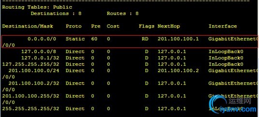

4.路由器R1 的配置
l 给路由器R1接口配ip地址和默认路由
sy
[Huawei]int g0/0/0
[Huawei-GigabitEthernet0/0/0]ipadd 201.100.100.2 24
[Huawei]ip route-s
[Huawei]ip route-static 0.0.0.0 0.0.0.0 201.100.100.1
l  用display ip int b查看接口配置,用displayip routing-t查看路由表,结果如图
