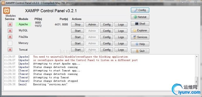

Apache启动提示
10:33:43  [Apache]Problem detected!
10:33:43  [Apache]Port 80 in use by "Unable to open process" with PID 4!
10:33:43  [Apache]Apache WILL NOT start without the configured ports free!
10:33:43  [Apache] Youneed to uninstall/disable/reconfigure the blocking application
10:33:43  [Apache] orreconfigure Apache and the Control Panel to listen on a different port
10:33:43  [Apache]Port 443 in use by ""C:\Program Files (x86)\VMware\VMwareWorkstation\vmware-hostd.exe" -u "C:\ProgramData\VMware\hostd\config.xml""with PID 5728!
网上找了解决办法
2.httpd-ssl.conf
我试过了还是没有解决
后来发现在xampp根目录下有两个个文件properties.ini和xampp-control.ini
1、打开properties.ini,找到
[General]
installdir=D:\xampp
base_stack_name=XAMPP
base_stack_version=1.8.3-1
base_stack_platform=windows
require_root_privileges=1
[Apache]
apache_server_port=80
apache_server_ssl_port=443
apache_root_directory=/xampp/apache
apache_htdocs_directory=D:\xampp/htdocs
apache_domainname=127.0.0.1
apache_configuration_directory=D:\xampp/apache/conf
apache_unique_service_name=
[MySQL]
mysql_port=3306
mysql_host=localhost
mysql_root_directory=D:\xampp\mysql
mysql_binary_directory=D:\xampp\mysql\bin
mysql_data_directory=D:\xampp\mysql\data
mysql_arguments=-u root -P3306
mysql_unique_service_name=
[PHP]
php_binary_directory=D:\xampp\php
php_configuration_directory=D:\xampp\php
红色标注部分设置了其实端口,依次修改成
apache_server_port=8088
apache_server_ssl_port=4431
1、打开xampp-control.ini,找到
[ServicePorts]
Apache=80
ApacheSSL=443
MySQL=3306
FileZilla=21
FileZillaAdmin=14147
Mercury1=25
Mercury2=79
Mercury3=105
Mercury4=106
Mercury5=110
Mercury6=143
Mercury7=2224
TomcatHTTP=8080
TomcatAJP=8009
Tomcat=8005
修改成
Apache=8088
ApacheSSL=4431
修改它。。。。
修改成8088,4431
重新启动,搞定。不容易啊。
