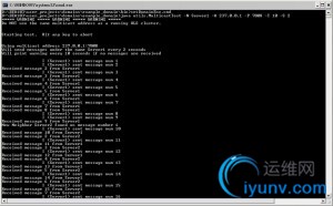

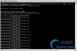

  Both servers will start sending and receiving messages as below:
  Server 1 :
  Server 2 :
  The screen shots show that there is no issue in the connectivity. But when there is a lost message, it will show the message:
