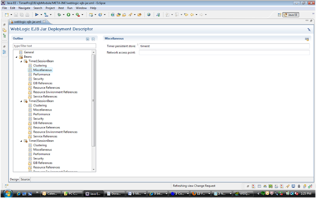

weblogic-ejb-jar.xml: some important configurations
<?xml version="1.0"encoding="UTF-8"?>
<wls:weblogic-ejb-jar xmlns:wls="http://xmlns.oracle.com/weblogic/weblogic-ejb-jar"xmlns:xsi="http://www.w3.org/2001/XMLSchema-instance"xsi:schemaLocation="http://java.sun.com/xml/ns/javaeehttp://java.sun.com/xml/ns/javaee/ejb-jar_3_0.xsd http://xmlns.oracle.com/weblogic/weblogic-ejb-jar http://xmlns.oracle.com/weblogic/weblogic-ejb-jar/1.0/weblogic-ejb-jar.xsd">
    <!--weblogic-version:10.3.2-->
    <wls:weblogic-enterprise-bean>
        <wls:ejb-name>Timer1SessionBean</wls:ejb-name>
        <wls:stateless-session-descriptor>
            <wls:timer-descriptor>
                <wls:persistent-store-logical-name>timerst</wls:persistent-store-logical-name>
            </wls:timer-descriptor>
        </wls:stateless-session-descriptor>
    </wls:weblogic-enterprise-bean>
        <wls:ejb-name>Timer2SessionBean</wls:ejb-name>
        <wls:ejb-name>Timer3SessionBean</wls:ejb-name>
    <wls:timer-implementation>Clustered</wls:timer-implementation>
</wls:weblogic-ejb-jar>
The most important things are that making sure the timers are cluster aware, and also using proper logical name for the persistent store  (timerst), which will be configured in the administrator console.
