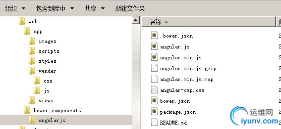

   安装 angularjs :
D:\web>bower install --save angularjs
bower angularjs#*               cached git://github.com/angular/bower-angular.git#1.3.3
bower angularjs#*             validate 1.3.3 against git://github.com/angular/bower-angular.git
bower angularjs#*                  new version for git://github.com/angular/bower-angular.git#*
bower angularjs#*              resolve git://github.com/angular/bower-angular.git#*
bower angularjs#*             download https://github.com/angular/bower-angular/archive/v1.3.4.
bower angularjs#*              extract archive.tar.gz
bower angularjs#*             resolved git://github.com/angular/bower-angular.git#1.3.4
bower angularjs#~1.3.4         install angularjs#1.3.4
angularjs#1.3.4 bower_components\angularjs

  打开web目录看一下:

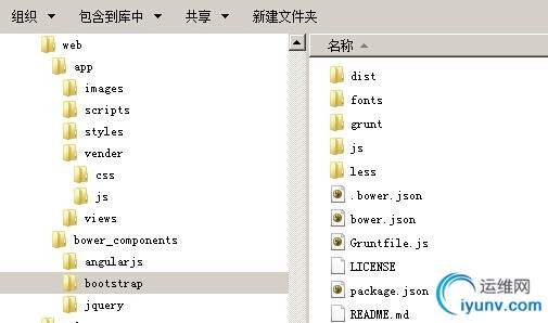

 目录结构:

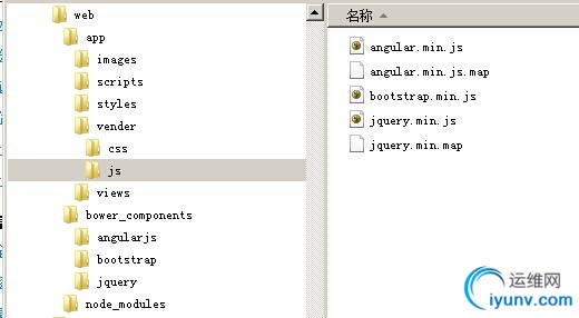

  查看vender目录:
 需要的js库文件已经copy 过来了。

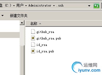

    先生成ssh key:
$ ssh-keygen -t rsa -C "java.yanlei@163.com"
    在 C:\Users\Administrator\.ssh下会生成密钥文件:
    把id_rsa.pub文件的内容配置到远程仓库中,就允许连接到远程仓库了。
