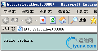

  可以再写个例子:
var http = require('http');
server = http.createServer(function (req, res) {
      res.writeHeader(200, {"Content-Type": "text/plain"});
      res.end("Hello oschina\n");
server.listen(8000);
console.log("httpd start @8000");
  环境应该差不多了。下面要开始用node.js写socketServer了
