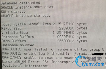

今天一个开发库启动不了了,发过来报错一看是日志文件损坏了(见下图),接着说了一下前因后果。说是年前服务器掉电了,然后就再没有启动起来过。今天有人用才想到要处理。

2、启动数据库出现报错
10
11
12
13
14
idle>startup
ORACLE instance started.
Total System Global Area 1603411968 bytes
Fixed Size         2253664 bytes
Variable Size       1476398240 bytes
Database Buffers     117440512 bytes
Redo Buffers           7319552 bytes
Database mounted.
ORA-00313: open failed for members of log group 2 of thread 1
ORA-00312: online log 2 thread 1: '/u02/app/oracle/oradata/orcl/redo02.log'
ORA-27037: unable to obtain file status
Linux-x86_64 Error: 2: No such file or directory
Additional information: 3
