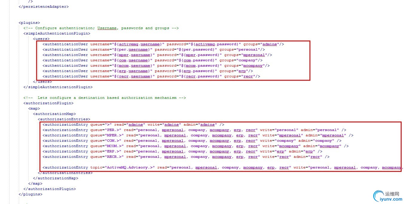

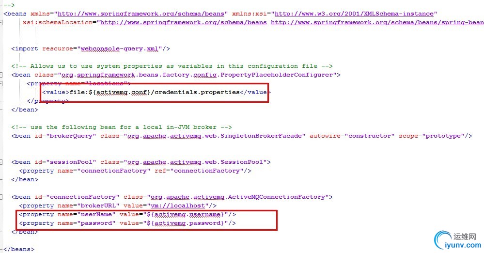

  修改文件%ACTIVEMQ_BASE%/conf/activemq.xml,用户名密码储存在文件%ACTIVEMQ_BASE%/conf/credentials.properties中,
  activemq.xml详细如下:

  <!-- Allows us to use system properties as variables in this configuration file -->
    <bean class="org.springframework.beans.factory.config.PropertyPlaceholderConfigurer">
        <property name="locations">
            <value>file:${activemq.conf}/credentials.properties</value>
        </property>
    </bean>

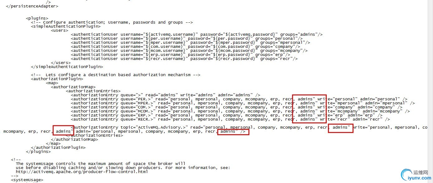

<plugins>
  <!-- Configure authentication; Username, passwords and groups -->
  <simpleAuthenticationPlugin>
  <users>
  <authenticationUser username="${activemq.username}" password="${activemq.password}" groups="admins"/>
  <authenticationUser username="${per.username}" password="${per.password}" groups="personal"/>
  <authenticationUser username="${mper.username}" password="${mper.password}" groups="mpersonal"/>
  <authenticationUser username="${com.username}" password="${com.password}" groups="company"/>
  <authenticationUser username="${mcom.username}" password="${mcom.password}" groups="mcompany"/>
  <authenticationUser username="${erp.username}" password="${erp.password}" groups="erp"/>
  <authenticationUser username="${recr.username}" password="${recr.password}" groups="recr"/>
  </users>
  </simpleAuthenticationPlugin>
  <!--  Lets configure a destination based authorization mechanism -->
  <authorizationPlugin>
<map>
  <authorizationMap>
<authorizationEntries>
  <authorizationEntry queue=">" read="admins" write="admins" admin="admins" />
  <authorizationEntry queue="PER.>" read="personal, mpersonal, company, mcompany, erp, recr" write="personal" admin="personal" />
  <authorizationEntry queue="MPER.>" read="personal, mpersonal, company, mcompany, erp, recr" write="mpersonal" admin="mpersonal" />
  <authorizationEntry queue="COM.>" read="personal, mpersonal, company, mcompany, erp, recr" write="company" admin="company" />
  <authorizationEntry queue="MCOM.>" read="personal, mpersonal, company, mcompany, erp, recr" write="mcompany" admin="mcompany" />
  <authorizationEntry queue="ERP.>" read="personal, mpersonal, company, mcompany, erp, recr" write="erp" admin="erp" />
  <authorizationEntry queue="RECR.>" read="personal, mpersonal, company, mcompany, erp, recr" write="recr" admin="recr" />
  <authorizationEntry topic="ActiveMQ.Advisory.>" read="personal, mpersonal, company, mcompany, erp, recr" write="personal, mpersonal, company, mcompany, erp, recr" admin="personal, mpersonal, company, mcompany, erp, recr" />

  credentials.properties详细如下:
## Licensed to the Apache Software Foundation (ASF) under one or more
## contributor license agreements.  See the NOTICE file distributed with
## this work for additional information regarding copyright ownership.
## The ASF licenses this file to You under the Apache License, Version 2.0
## (the "License"); you may not use this file except in compliance with
## the License.  You may obtain a copy of the License at
## http://www.apache.org/licenses/LICENSE-2.0
## Unless required by applicable law or agreed to in writing, software
## distributed under the License is distributed on an "AS IS" BASIS,
## WITHOUT WARRANTIES OR CONDITIONS OF ANY KIND, either express or implied.
## See the License for the specific language governing permissions and
## limitations under the License.
  # Defines credentials that will be used by components (like web console) to access the broker
  activemq.username=***
activemq.password=***
  per.username=***
per.password=***
  mper.username=***
mper.password=***
  com.username=***
com.password=***
  mcom.username=***
mcom.password=***
  erp.username=***
erp.password=***
  recr.username=***
recr.password=***
  以上配置今天发现队列监控出现异常,最后查到问题出现在这里:
  由于队列监控项目admin里使用的账户为system/manager(webapps\admin\WEB-INF\webconsole-embedded.xml
  ),属于admins群组,需要加上权限。
