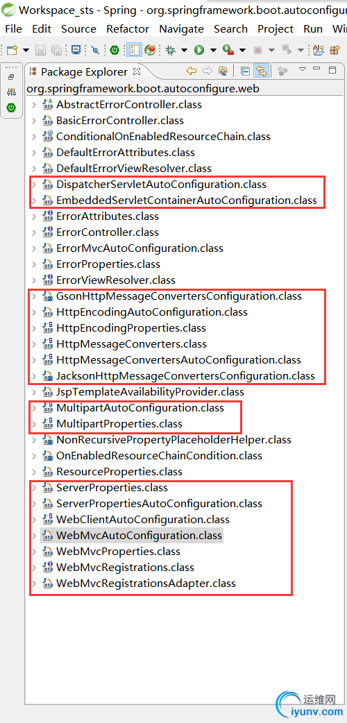

Spring MVC的自动配置在包 org.springframework.boot.autoconfigure.web 之下,该包中的内容如下:
从上图中可以清楚的看到Spring Boot为Spring MVC提供了哪些自动配置:
  • DispatcherServletAutoConfiguration.class
  • EmbeddedServletContainerAutoConfiguration.class
  • ErrorMvcAutoConfiguration.class
  • GsonHttpMessageConvertersConfiguration.class
  • HttpEncodingAutoConfiguration.class
  • HttpMessageConvertersAutoConfiguration.class
  • JacksonHttpMessageConvertersConfiguration.class
  • MultipartAutoConfiguration.class
  • ServerPropertiesAutoConfiguration.class
  • WebClientAutoConfiguration.class
  • WebMvcAutoConfiguration.class
