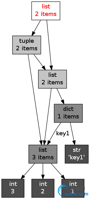

容器对象的引用可能构成很复杂的拓扑结构。我们可以用objgraph包来绘制其引用关系,比如
x = [1, 2, 3]
y = [x, dict(key1=x)]
z = [y, (x, y)]
import objgraph
objgraph.show_refs([z], filename='ref_topo.png')
