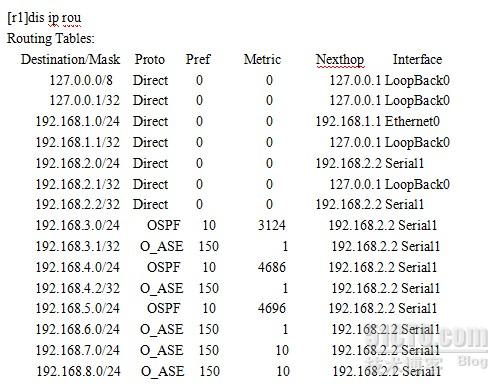

R1
[r1]
[r1]dis cu
  Now create configuration...
  Current configuration
    version 1.74
    sysname r1
    undo pos-server addr-switch
    firewall enable
    aaa-enable
    aaa accounting-scheme optional
  controller e1 0
  interface Aux0
    async mode flow
    link-protocol ppp
  interface Ethernet0
    loopback
    ip address 192.168.1.1 255.255.255.0
    ospf enable area 0.0.0.1
  interface Ethernet1
  interface Serial0
    link-protocol ppp
  interface Serial1
    link-protocol ppp
    ip address 192.168.2.1 255.255.255.0

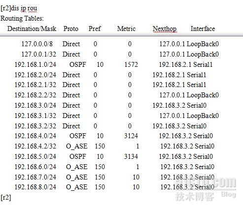

R2
[r2]dis cu
    version 1.74
    sysname r2
    firewall enable
    aaa-enable
  interface Aux0
    async mode flow
    link-protocol ppp
  interface Ethernet0
  interface Ethernet1
  interface Serial0
    clock DTECLK1
    link-protocol ppp
    ip address 192.168.3.1 255.255.255.0
    ospf enable area 0.0.0.0
  interface Serial1
    clock DTECLK1
    link-protocol ppp
    ip address 192.168.2.2 255.255.255.0

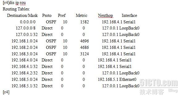

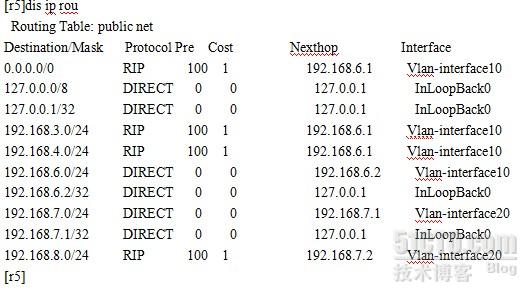

R5
r5>sys
<r5>system-view
Enter system view, return to user view with Ctrl+Z.
[r5]dis cu
sysname r5
radius scheme system
server-type huawei
primary authentication 127.0.0.1 1645
primary accounting 127.0.0.1 1646
user-name-format without-domain
domain system
radius-scheme system
access-limit disable
state active
vlan-assignment-mode integer
idle-cut disable
self-service-url disable
messenger time disable
domain default enable system
local-server nas-ip 127.0.0.1 key huawei
vlan 1
vlan 10
vlan 20
interface Vlan-interface10
ip address 192.168.6.2 255.255.255.0
interface Vlan-interface20
ip address 192.168.7.1 255.255.255.0
interface Aux0/0
interface Ethernet0/1
port access vlan 10
interface Ethernet0/24
port access vlan 20
interface NULL0
rip
undo summary
network 192.168.6.0
network 192.168.7.0
user-interface aux 0
user-interface vty 0 4
return

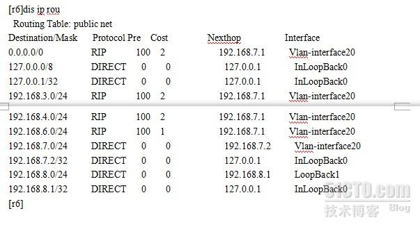

R6
[r6]dis cu
sysname r6
server-type huawei
domain system
state active
idle-cut disable
vlan 1
vlan 20
ip address 192.168.7.2 255.255.255.0
interface Aux0/0
port access vlan 20
interface NULL0
interface LoopBack1
ip address 192.168.8.1 255.255.255.0
rip
undo summary
network 192.168.7.0
network 192.168.8.0
return

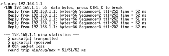

  配置完毕后,就要进行测试了,下面就是本实验的测试结果:
由此看来,本实验一成功了。我刚真正的去学设配,希望广大同门多多指教!!!
