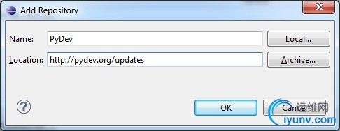

  (2) 点击Add添加安装地址
  (3) 选择Pydev->PyDev for Eclipse,不勾选'Contact all update sites during install to find required software' ,点Next继续

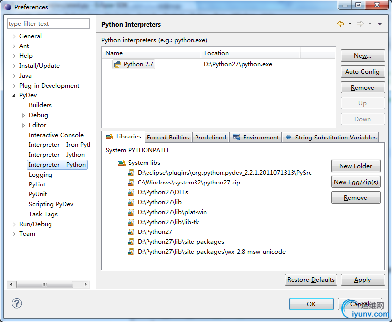

  3、配置Pydev
  (1) Window->Perference->Pydev->Interpreter->Python
  (2) 点New,选择Python解释器的路径并命名解释器,点Select All选择所有文件夹加入路径,如图所示完成配置。
