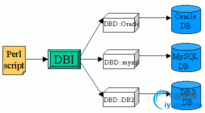

2. You can see below the basic DBI model. The scripts are written in Perl using standard Perl variables, commands and syntax. The DBI has methods and handles which are database software independent. You program to access, change or query a database using the standard SQL language, combined with the DBI methods and handles. You install as many DBD::type modules as you need to support the different database software you may have, but you Perl script will be the same.
<!--[if gte vml 1]><v:shapetype id="_x0000_t75"coordsize="21600,21600" o:spt="75" o:preferrelative="t" path="m@4@5l@4@11@9@11@9@5xe"filled="f" stroked="f"><v:stroke joinstyle="miter" /><v:formulas><v:f eqn="if lineDrawn pixelLineWidth 0" /><v:f eqn="sum @0 1 0" /><v:f eqn="sum 0 0 @1" /><v:f eqn="prod @2 1 2" /><v:f eqn="prod @3 21600 pixelWidth" /><v:f eqn="prod @3 21600 pixelHeight" /><v:f eqn="sum @0 0 1" /><v:f eqn="prod @6 1 2" /><v:f eqn="prod @7 21600 pixelWidth" /><v:f eqn="sum @8 21600 0" /><v:f eqn="prod @7 21600 pixelHeight" /><v:f eqn="sum @10 21600 0" /></v:formulas><v:path o:extrusionok="f" gradientshapeok="t" o:connecttype="rect" /><o:lock v:ext="edit" aspectratio="t" /></v:shapetype><v:shape id="_x0000_i1025" type="#_x0000_t75" alt="" style='width:306pt;height:169.5pt'><v:imagedata src="file:///C:\DOCUME~1\Hemin\LOCALS~1\Temp\msohtml1\01\clip_image001.gif"o:href="http://home.ubalt.edu/abento/752/dbi/DBImodel.gif" /></v:shape><![endif]--><!--[if !vml]--><!--[endif]--> DSC0000.gif
