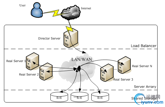

LVS
(Linux Virtual Server)是一个高可用性虚拟的服务器集群系统。本项目在1998年5月由章文嵩博士成立,是中国国内最早出现的自由软件项目之一。LVS主要用于多服务器的负载均衡,作用于网络层。LVS构建的服务器集群系统中,前端的负载均衡层被称为Director Server;后端提供服务的服务器组层被称为Real Server。通过下图可以大致了解LVS的基础架构。
LVS有三种工作模式,分别是DR(Direct Routing 直接路由)、TUN(Tunneling IP隧道)、NAT(Network Address Translation 网络地址转换)。其中TUN模式能够支持更多的Real Server,但需要所有服务器支持IP隧道协议;DR也可以支持相当的Real Server,但需要保证Director Server虚拟网卡与物理网卡在同一网段;NAT扩展性有限,无法支持更多的Real Server,因为所有的请求包和应答包都需要Director Server进行解析再生,影响效率。 同时,LVS负载均衡有10中调度算法,分别是rr、wrr、lc、wlc、lblc、lblcr、dh、sh、sed、nq(详细介绍本文不在说明)

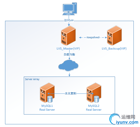

LVS+Keepalived配置环境准备
LVS1:172.30.8.192
​LVS2:172.30.8.193
MySQL Server1:172.30.8.190
MySQL Server2:172.30.8.191
VIP:172.30.8.200
OS: CentOS 6.5

测试验证
关闭MySQL Server2
[iyunv@mysql-2 ~]# service mysqld stop
Stopping mysqld:                                           [  OK  ]
在LVS1查看/var/log/messages中关于keepalived日志,LVS1检测到了MySQL Server2宕机,同时LVS集群自动剔除了故障节点
May 18 23:52:26 localhost Keepalived_healthcheckers[5909]: TCP connection to [172.30.8.191]:3306 failed !!!
May 18 23:52:26 localhost Keepalived_healthcheckers[5909]: Removing service [172.30.8.191]:3306 from VS [172.30.8.200]:3306
从新启动MySQL Server2后自动将故障节点自动加入LVS集群
May 18 23:53:50 localhost Keepalived_healthcheckers[5909]: TCP connection to [172.30.8.191]:3306 success.
May 18 23:53:50 localhost Keepalived_healthcheckers[5909]: Adding service [172.30.8.191]:3306 to VS [172.30.8.200]:3306
关闭LVS1上的Keepalived(模拟宕机操作),查看LVS1上的日志,可以看到Keepalived移出了LVS1上的VIP
May 18 23:54:28 localhost Keepalived[5908]: Stopping Keepalived v1.2.13 (05/17,2017)
May 18 23:54:28 localhost Keepalived_vrrp[5910]: VRRP_Instance(VI_1) sending 0 priority
May 18 23:54:28 localhost Keepalived_vrrp[5910]: VRRP_Instance(VI_1) removing protocol VIPs.
May 18 23:54:28 localhost Keepalived_healthcheckers[5909]: Netlink reflector reports IP 172.30.8.200 removed
May 18 23:54:28 localhost Keepalived_healthcheckers[5909]: Removing service [172.30.8.190]:3306 from VS [172.30.8.200]:3306
May 18 23:54:28 localhost Keepalived_healthcheckers[5909]: Removing service [172.30.8.191]:3306 from VS [172.30.8.200]:3306
同时查看LVS2上日志,可以看到LVS2成为了Master,并接管了VIP
May 18 23:54:29 localhost Keepalived_vrrp[5187]: VRRP_Instance(VI_1) Transition to MASTER STATE
May 18 23:54:30 localhost Keepalived_vrrp[5187]: VRRP_Instance(VI_1) Entering MASTER STATE
May 18 23:54:30 localhost Keepalived_vrrp[5187]: VRRP_Instance(VI_1) setting protocol VIPs.
May 18 23:54:30 localhost Keepalived_healthcheckers[5186]: Netlink reflector reports IP 172.30.8.200 added
May 18 23:54:30 localhost Keepalived_vrrp[5187]: VRRP_Instance(VI_1) Sending gratuitous ARPs on eth0 for 172.30.8.200
May 18 23:54:35 localhost Keepalived_vrrp[5187]: VRRP_Instance(VI_1) Sending gratuitous ARPs on eth0 for 172.30.8.200
在LVS2上查看LVS集群状态,一切正常
[iyunv@lvs-2 ~]# ipvsadm -ln
IP Virtual Server version 1.2.1 (size=4096)
Prot LocalAddress:Port Scheduler Flags
  -> RemoteAddress:Port           Forward Weight ActiveConn InActConn
TCP  172.30.8.200:3306 wlc
  -> 172.30.8.190:3306            Route   3      0          0
  -> 172.30.8.191:3306            Route   3      1          0

    MySQL主主复制是集群的基础,组成Server Array,其中每个节点作为Real Server。
    LVS服务器提供了负载均衡的作用,将用户请求分发到Real Server,一台Real Server故障并不会影响整个集群的。
    Keepalived搭建主备LVS服务器,避免了LVS服务器的单点故障,出现故障时可以自动切换到正常的节点。
