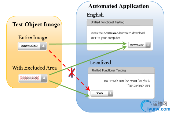

  Exclude Areas
  There are cases in which a UI control contains areas that change without affecting the functionality of the control, and therefore make the image less useful for identification purposes. Such areas may change at random (e.g. advertisements), be dynamically generated (e.g. weather forecasts), or contain text which is localized to different languages. By adding Excluded Areas to the image we can specify that only parts of the captured image should be matched against the application, and the other areas can safely be ignored:
