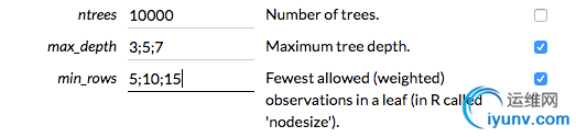

Selecting Hyperparameters Manually and With Cartesian Grid
  The traditional method of selecting the values for your hyperparameters has been to individually train a number of models with different combinations of values, and then to compare the model performance to choose the best model. For example, for a tree-based model you might choose ntrees of (50, 100 and 200) and max_depth of (5, 10, 15 and 20) for a total of 3 x 4 = 12 models. This process of trying out hyperparameter sets by hand is called manual search. By looking at the models’ predictive performance, as measured by test-set, cross-validation or validation metrics, you select the best hyperparameter settings for your data and needs.
  As the number of hyperparameters and the lists of desired values increase this obviously becomes quite tedious and difficult to manage.

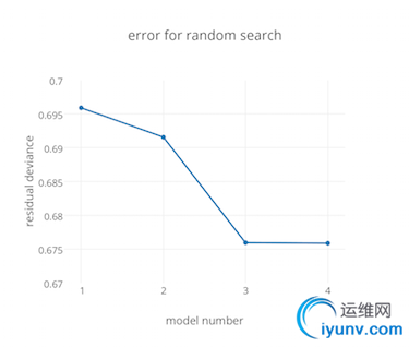

  H2O keeps track of all the models resulting from the search, and allows you to sort the list based on any supported model metric (e.g., AUC or log loss). For the example above, H2O would build your 12 models and return the list sorted with the best first, either using the metric of your choice or automatically using one that’s generally appropriate for your model’s category.
  H2O allows you to run multiple hyperparameter searches and to collect all the models for comparison in a single sortable result set: just name your grid and run multiple searches. You can even add models from manual searches to the result set by specifying a grid search with a single value for each interesting hyperparameter:

  After doing a random search, if desired you can then iterate by “zooming in” on the regions of the hyperparameter space which look promising. You can do this by running additional, more targeted, random or Cartesian hyperparameter searches or manual searches. For example, if you started with alpha values of [0.0, 0.25, 0.5, 0.75, 1.0] and the middle values look promising, you can follow up with a finer grid of [0.3, 0.4, 0.5, 0.6, 0.7].
