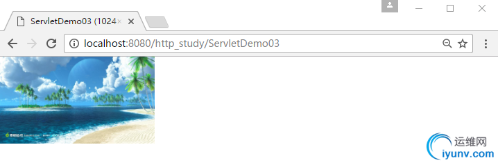

4.3、设置content-type响应头,指定回送数据类型
  浏览器能接收(Accept)的数据类型有:
application/x-ms-application,
image/jpeg,
application/xaml+xml,
image/gif,
image/pjpeg,
application/x-ms-xbap,
application/vnd.ms-excel,
application/vnd.ms-powerpoint,
application/msword,
package servlet;
import java.io.IOException;
import java.io.InputStream;
import java.io.OutputStream;
import javax.servlet.ServletException;
import javax.servlet.http.HttpServlet;
import javax.servlet.http.HttpServletRequest;
import javax.servlet.http.HttpServletResponse;
public class ServletDemo03 extends HttpServlet {
     private static final long serialVersionUID = 1L;
     protected void doGet(HttpServletRequest request, HttpServletResponse response) throws ServletException, IOException {
         this.doPost(request, response);
     protected void doPost(HttpServletRequest request, HttpServletResponse response) throws ServletException, IOException {
         //使用content-type指定发送给浏览器的数据类型为image/jpeg
         response.setHeader("content-type", "image/jpeg");
         //获取流
         InputStream in=request.getServletContext().getResourceAsStream("/images/1.jpg");
         //InputStream in=new InputStream("/images/1.jpg");
         byte[] b=new byte[1024];
         int ln=0;
         OutputStream os=response.getOutputStream();
         while((ln=in.read(b))!=-1){
             os.write(b,0,ln);
  得到的响应为如图:
  运行结果如下:
