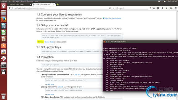

  ROS安装: ros 是一个framework 和Android有点像,内核用的linux。Ros提供了一种供机器人开发者迅速上手的一个平台,
  可以快速搭建自己的应用,利用ros下面自带的应用,不需要自己再重复写程序。
  1、ros官网资料很多
  http://www.ros.org/ ros官网
  点击进入wiki ,里面有ros安装等一系列教程。

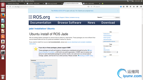

  2、注重平台选择,相应的Ubuntu版本对应着相应的Ros版本。这点需要大家搞清楚。
  平台选择: Ubuntu: 14.04
  Ros : Jade
  小助手:如何查看ros安装版本。

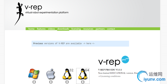

  3、安装Vrep
  搜索Vrep 安装,打开主页,选择相应的版本进行安装。
  目前我们选择的是 PRO-EDU-V3_3_1_64.
  Vrep 本身是一个开源项目,只需要git 就可以把Vrep 给下载下来。当然,需要我们选择合适的版本。

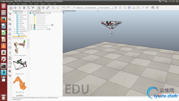

  打开VREP程序:通过.sh脚本文件打开。

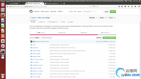

  4、安装完VREP和ROS之后,如何进行两者间等人通信?
  需要安装插件,Vrep_ros_bridge.git
  在gitHub上面有详细的安装过程,大家可以去参考。
  此插件安装过程中,可能并不会成功,因为有些直接或间接依赖。

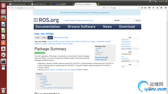

  这两天安装好vrep的库和插件
http://wiki.ros.org/vrep_ros_bridge
  vrep_ros_bridage installation:

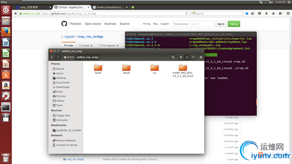

  final solve method:
  ###Installation Plugin
  1 Go in the src folder of your catkin workspace in catkin_ws/src via terminal
  2 Download the plugin from GIT typing:
  `git clone https://github.com/lagadic/vrep_ros_bridge.git`
  • Delete the file "quadrotor_tk_handler" for it has a strange depends package "telekyb_msgs" which is useless for us and will result a missing package error.  3 Open the file bashrc:
      gedit ~/.bashrc
      in the end of the file add:
      export VREP_ROOT_DIR=/ChangeWithyourPathToVrep
      and, if you want to avoid to type the following command every time(not mandatory):
      export ROS_PACKAGE_PATH=${ROS_PACKAGE_PATH}:/path_to_catkin_ws/catkin_ws/src
      source /opt/ros/indigo/setup.bash
      source /path_to_catkin_ws/catkin_ws/devel/setup.bash
      4 Go in your catkin_workspace and run:
      catkin_make
      5 Now build again the pkg using the next instruction:
      catkin_make --pkg vrep_ros_bridge --cmake-args -DCMAKE_BUILD_TYPE=RelWithDebInfo
      6 使用终端到V-Rep安装目录下,并输入:
      ln -s /YOUR_CATKIN_WS_PATH/devel/lib/libv_repExtRosBridge.so
      (very important: notice that you should first "cd VREP_INSTALL_FOLDER", and in this folder input "ln -s /YOUR_CATKIN_WS_PATH/devel/lib/libv_repExtRosBridge.so" which means you should put the link of libv_repExtRosBridge.so in the vrep startup path)
      7 If you are using a new version of V-REP (V3_3_1_64_Linux) we need an additional step. We need to create a link pointing to the file compiledRosPlugins/libv_repExtRos.so in the V-REP root folder. Go via terminal to the installation folder of V-Rep and type: (it's optional)
      ln -s compiledRosPlugins/libv_repExtRos.so
