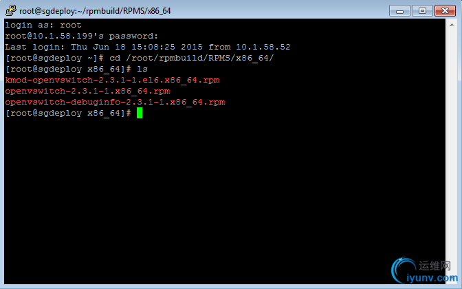

  Then to build the rpms. This can take a few minutes:
  rpmbuild -bb rhel/openvswitch.spec
rpmbuild -bb rhel/openvswitch-kmod-rhel6.spec
  ※如果没有rpmbuild命令,则yum install rpm-build 安装
  ※ openssl-devel is needed by openvswitch-2.5.0-1.x86_64,如果 没有openssl-devel,则yum install openssl-devel 安装
  Now the rpms are sitting on my deployment server ready to be copied to my KVM nodes.
  Copy the Open vSwitch rpms to the KVM node, using SCP.
  scp -r root@sgdeploy:/root/rpmbuild/RPMS/x86_64 .
