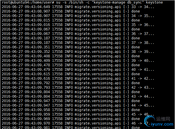

(5)填充keystone数据库
$  su -s /bin/sh -c "keystone-manage db_sync" keystone   DSC0000.png
  修这里最好切换至root用户同步,否者会同步不成功。

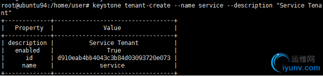

  e.创建service租户
$  keystone tenant-create --name service --description "Service Tenant"

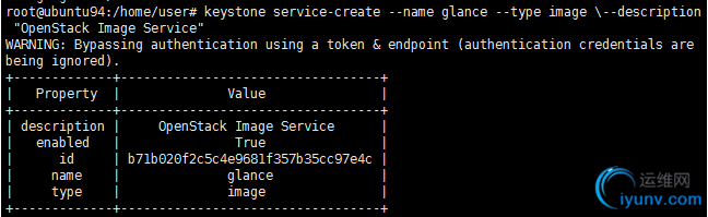

(5)创建glance的service服务
keystone service-create --name glance --type image \--description "OpenStack Image Service"

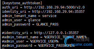

b.在 [keystone_authtoken] 和 [paste_deploy] 部分, 修改配置:
auth_uri = http:// <192.168.1.1>:5000/v2.0
identity_uri = http:// <192.168.1.1>:35357
admin_tenant_name = service
admin_user = glance
admin_password = <GLANCE_PASS>
auth_uri = http://192.168.29.94:5000/v2.0
identity_uri = http://192.168.29.94:35357
admin_user = glance
admin_password = GLANCE_PASS
c.在注释掉下面的内容
#identity_uri = http://127.0.0.1:35357

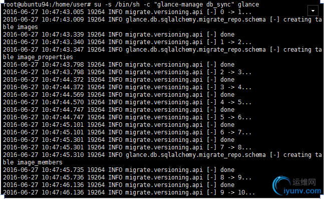

(10)填充glance数据库
su -s /bin/sh -c "glance-manage db_sync" glance
(11)重启服务
$  service glance-registry restart
$ DSC00015.png    service glance-api restart

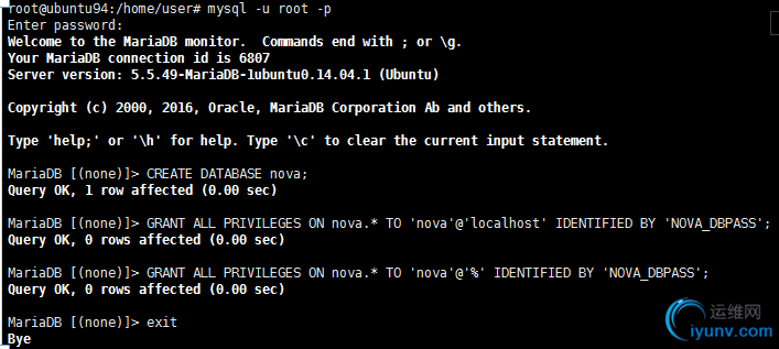

(1)创建nova数据库并授权
$  mysql -u root -p
$  CREATE DATABASE nova;
GRANT ALL PRIVILEGES ON nova.* TO 'nova'@'localhost' \IDENTIFIED BY '<NOVA_DBPASS>';
GRANT ALL PRIVILEGES ON nova.* TO 'nova'@'%' \IDENTIFIED BY '<NOVA_DBPASS>';
$  GRANT ALL PRIVILEGES ON nova.* TO 'nova'@'localhost' IDENTIFIED BY 'NOVA_DBPASS';
$  GRANT ALL PRIVILEGES ON nova.* TO 'nova'@'%' IDENTIFIED BY 'NOVA_DBPASS';
退出mysql
$  exit

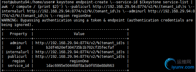

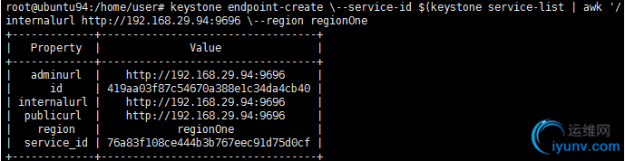

(4)创建nova服务API endpoints
keystone endpoint-create \--service-id $(keystone service-list | awk '/ compute / {print $2}') \--publicurl http://< 192.168.1.1>:8774/v2/%\(tenant_id\)s \--internalurl http:// <192.168.1.1>:8774/v2/%\(tenant_id\)s \--adminurl http:// <192.168.1.1>:8774/v2/%\(tenant_id\)s \--region regionOne
$  keystone endpoint-create \--service-id $(keystone service-list | awk '/ compute / {print $2}') \--publicurl http://192.168.29.94:8774/v2/%\(tenant_id\)s \--internalurl http://192.168.29.94:8774/v2/%\(tenant_id\)s \--adminurl http://192.168.29.94:8774/v2/%\(tenant_id\)s \--region regionOne

      keystone: error: unrecognized arguments: 5b188243fee44d21bd622626d0e061e7
解决办法:
有两个,删掉一个即可:
keystone service-delete cf4399b85ab14cfb81beb3bb9d53b8dd

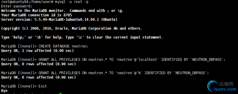

(1)创建数据并授权
$  mysql -u root -p
$  CREATE DATABASE neutron;
GRANT ALL PRIVILEGES ON neutron.* TO 'neutron'@'localhost' \IDENTIFIED BY '<NEUTRON_DBPASS>';
GRANT ALL PRIVILEGES ON neutron.* TO 'neutron'@'%' \IDENTIFIED BY '<NEUTRON_DBPASS>';
$  GRANT ALL PRIVILEGES ON neutron.* TO 'neutron'@'localhost' IDENTIFIED BY 'NEUTRON_DBPASS';
$  GRANT ALL PRIVILEGES ON neutron.* TO 'neutron'@'%' IDENTIFIED BY 'NEUTRON_DBPASS';
退出mysql
$  Exit

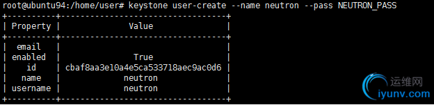

a.创建neutron用户
keystone user-create --name neutron --pass <NEUTRON_PASS>
$  keystone user-create --name neutron --pass NEUTRON_PASS

d.创建网路服务 API endpoints:
keystone endpoint-create \--service-id $(keystone service-list | awk '/ network / {print $2}') \--publicurl http:// <192.168.1.1>:9696 \--adminurl http:// <192.168.1.1>:9696 \--internalurl http:// <192.168.1.1>:9696 \--region regionOne
$  keystone endpoint-create \--service-id $(keystone service-list | awk '/ network / {print $2}') \--publicurl http://192.168.29.94:9696 \--adminurl http://192.168.29.94:9696 \--internalurl http://192.168.29.94:9696 \--region regionOne

注意,这里SERVICE_TENANT_ID是keystone service 租户id 。nova_pass是nova用户密码,这是使用的是默认密码, SERVICE_TENANT_ID的查询方式如下:
$  source admin_creds

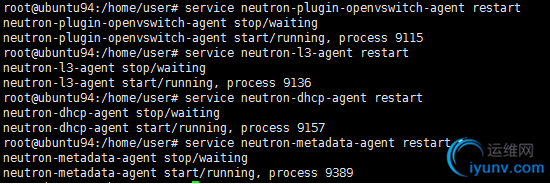

(17)重启网络服务
$  service neutron-server restart
