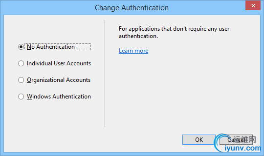

  •   In the New ASP.NET Project dialog, and select MVC, and click Change Authentication.
  •   Select No Authentication in the Change Authentication dialog, and click OK.

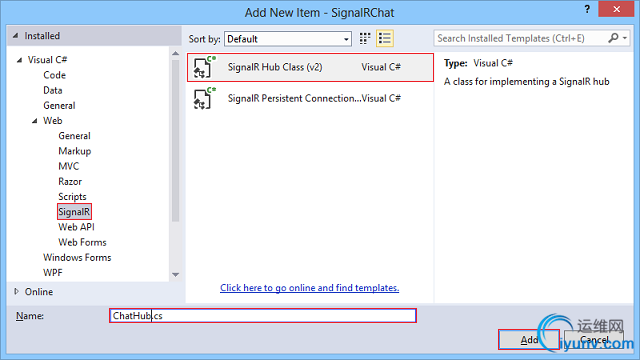

  •   In Solution Explorer, right-click the project, select Add | New Folder, and add a new folder named Hubs.
  •   Right-click the Hubs folder, click Add | New Item, select the Visual C# | Web | SignalR node in the Installed pane, select SignalR Hub Class (v2) from the center pane, and create a new hub named ChatHub.cs. You will use this class as a SignalR server hub that sends messages to all clients.

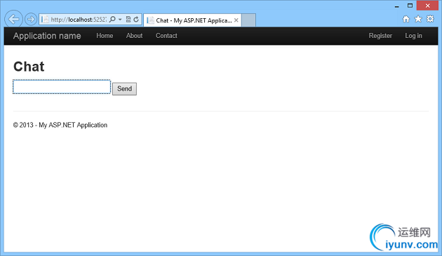

Run the Sample
  •   Press F5 to run the project in debug mode.
  •   In the browser address line, append /home/chat to the URL of the default page for the project. The Chat page loads in a browser instance and prompts for a user name.
  •   Enter a user name.
  • Copy the URL from the address line of the browser and use it to open two more browser instances. In each browser instance, enter a unique user name.
  •   In each browser instance, add a comment and click Send. The comments should display in all browser instances.
      Note: This simple chat application does not maintain the discussion context on the server. The hub broadcasts comments to all current users. Users who join the chat later will see messages added from the time they join.
  •   The following screen shot shows the chat application running in a browser.
