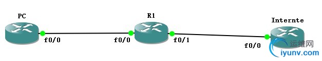

  实验二、扩展ACL
  PC1配置:
  PC1#conf t
  PC1(config)#no ip routing
  PC1(config)#ip default-gateway192.168.0.1
  PC1(config)#int fa0/0
  PC1(config-if)#ip add192.168.0.2 255.255.255.0
  PC1(config-if)#no sh
  PC1(config-if)#exit
  R1配置:
  R1#conf t
  R1(config)#int fa0/0
  R1(config-if)#ip add192.168.0.1 255.255.255.0
  R1(config-if)#no sh
  R1(config-if)#exit
  R1(config)#int fa0/1
  R1(config-if)#ip add202.100.100.1 255.255.255.0
  R1(config-if)#no sh
  R1(config-if)#exit
  Server配置:
  Server(config)#username ciscoprivilege 15 password cisco
  Server(config)#line vty 0 4
  Server(config-line)#login local
  Server(config-line)#exit
  Server(config)#ip http server
  Server(config)#int fa0/1
  Server(config-if)#ip add202.100.100.80 255.255.255.0
  Server(config-if)#no sh
  Server(config-if)#exit
  Server(config)#ip route 0.0.0.00.0.0.0 202.100.100.1
  Server(config)#access-list 100permit tcp any 202.100.100.80 0.0.0.0 eq www
  Server(config)# access-list 100permit tcp host 192.168.0.254 host 202.100.100.80 eq 23
  Server(config)#access-list 100deny  ip any any
  Server(config-if)#ipaccess-group 100 in
  測试检查:
  PC1#ping 202.100.100.80 //拒绝telnet和web之外的一起流量进入
  Type escape sequence to abort.
  Sending 5, 100-byte ICMP Echosto 202.100.100.80, timeout is 2 seconds:
  UUUUU
  Success rate is 0 percent (0/5)
  PC1#telnet 202.100.100.80 //仅仅同意192.168.0.254的主机telnet到服务器上
  Trying 202.100.100.80 ...
  % Destination unreachable;gateway or host down
  PC1#telnet 202.100.100.80 80 //能够訪问站点port80(www)
  Trying 202.100.100.80, 80 ...Open
  HTTP/1.1 400 Bad Request
  Date: Fri, 01 Mar 2002 00:22:11GMT
  Server: cisco-IOS
  Accept-Ranges: none
  400 Bad Request
  [Connection to 202.100.100.80closed by foreign host]

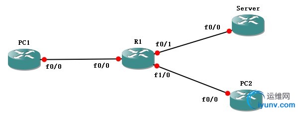

  实验三、命名式的ACL
  PC1配置:
  PC1#conf t
  PC1(config-if)#ip add192.168.1.100 255.255.255.0
  PC1(config-if)#exit
  PC1(config)#ip default-gateway192.168.1.1
  PC2配置:
  PC2#conf t
  PC2(config)#int fa0/0
  PC2(config-if)#ip add172.168.2.22 255.255.255.0
  PC2(config-if)#no sh
  PC2(config-if)#exit
  PC2(config)#ip route 0.0.0.00.0.0.0 172.168.2.1
  Server配置:
  Server#conf t
  Server(config)#int fa0/0
  Server(config-if)#ip add202.100.100.100 255.255.255.0
  R1配置:
  R1#conf t
  R1(config-if)#ip add192.168.1.1 255.255.255.0
  R1(config-if)#no sh
  R1(config-if)#exit
  R1(config-if)#no sh
  R1(config-if)#exit
  R1(config)#int fa1/0
  R1(config-if)#ip add 172.168.2.1255.255.255.0
  R1(config-if)#no sh
  R1(config-if)#exit
  R1(config)#ip access-liststandard pc1-to-pc2 //创建一条pc1到pc2的标准命名ACL
   R1(config-std-nacl)#10 deny 192.168.1.00.0.0.255 log//拒绝pc1的訪问
  R1(config-std-nacl)#20 permitany //其它流量全部同意
  R1(config-std-nacl)#exit
  R1(config)#ip access-listextended client-to-server //创建一条客户端到服务器的扩展命名ACL
  R1(config-ext-nacl)#10 permittcp any host 202.100.100.100 eq 80//全部主机能够訪问服务器的80
  R1(config-ext-nacl)# 20 permittcp 172.168.2.0 0.0.0.255 host 202.100.100.100 eq 23 //仅仅同意172.168.2.0能够telnet设备。
  R1(config-ext-nacl)#30 deny ipany any //其它流量全部掉弃
  R1(config-ext-nacl)#exit
  R1(config-if)#ip access-grouppc1-to-pc2 out //把pc1-to-pc2应用到fa1/0的出方向
  R1(config-if)#exit
  R1(config-if)#ip access-groupclient-to-server out //把client-to-server应用到fa0/1的进方向
  R1(config-if)#exit
  检查測试:
  PC1#ping 172.168.2.22 //PC1无法訪问PC2
  Sending 5, 100-byte ICMP Echosto 172.168.2.22, timeout is 2 seconds:
  U.U.U
  PC1#telnet 202.100.100.100//PC1不能訪问server的telnet服务(23port)
  Trying 202.100.100.100 ...
  PC1#telnet 202.100.100.100 80//PC1能够訪问server的www服务(80port)
  Trying 202.100.100.100, 80 ... Open
  Date: Fri, 01 Mar 2002 00:57:16GMT
  Server: cisco-IOS
  Accept-Ranges: none
  400 Bad Request
  [Connection to 202.100.100.100closed by foreign host]
  PC2#telnet 202.100.100.100//PC2能够telnet服务器的23port
  Trying 202.100.100.100 ... Open
  User Access Verification
  Username: cisco

  实验五、ACL中的establish实现TCP的单向通信
  PC1配置:
  C#conf t
  PC(config)#no ip routing
  PC(config)#ip default-gateway192.168.0.1
  PC(config)#int fa0/0
  PC(config-if)#ip add192.168.0.11 255.255.255.0
  PC(config-if)#no sh
  PC(config-if)#exit
  PC(config)#line vty 0 4
  PC(config-line)#login local
  PC(config-line)#exit
  PC(config)#username cisco privilege15 password cisco
  Internet配置:
  Internte#conf t
  Internte(config)#int fa0/0
  Internte(config-if)#ip add202.100.100.100 255.255.255.0
  Internte(config-if)#no sh
  Internte(config-if)#exit
  Internte(config)#ip route0.0.0.0 0.0.0.0 202.100.100.1
  Internte(config)#line vty 0 4
  Internte(config-line)#loginlocal
  Internte(config-line)#exit
  Internte(config)#username ciscoprivilege 15 password cisco
  R1配置:
  R1#conf t
  R1(config-if)#no sh
  R1(config-if)#exit                    ^
  R1(config-if)#no sh
  R1(config-if)#exit
  R1(config)#ip access-listextended tcp-establish
  R1(config-ext-nacl)#10 permittcp any 192.168.0.0 0.0.0.255 established//同意已经建立连接的从外网返回的TCP数据通过
   R1(config-ext-nacl)#20 deny ip any any //拒绝全部流量
  R1(config-if)#ip access-grouptcp-establish in
  R1(config-if)#exit
  检查測试:
  PC#ping 202.100.100.100 //内部发起的icmp出不去
  Sending 5, 100-byte ICMP Echosto 202.100.100.100, timeout is 2 seconds:
  PC#telnet 202.100.100.100 //内部发起tcp的telnet能够出去
  Username: cisco
  Password:
  Internte#q
  Internte#ping 192.168.0.11 //外部发起的ICMP进不来
  Sending 5, 100-byte ICMP Echosto 192.168.0.11, timeout is 2 seconds:
  UUUUU
  Internte#telnet 192.168.0.11 //外部发起TCP的telnet进不来
  Trying 192.168.0.11 ...
