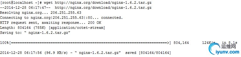

    1.下载nginx-1.6.2.tar.gz源码包
            wget http://nginx.org/download/nginx-1.6.2.tar.gz                     wKioL1SgwLmwPVbxAAGgnCTUqWo101.jpg
