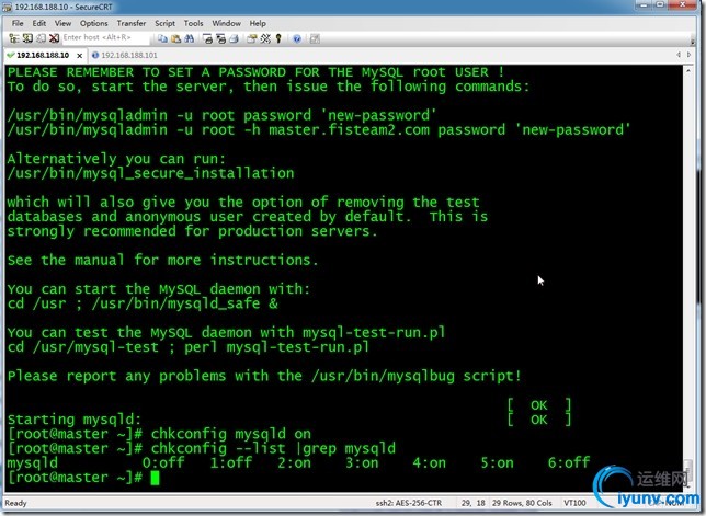

安装mysql
[iyunv@master ~]# yum install -y mysql mysql-devel mysql-server
优化mysql设置
编辑 /etc/my.cnf, 在[mysqld]字段,增加最后一行
[iyunv@master ~]# vim /etc/my.cnf
启动Mysql服务
[iyunv@master ~]# service mysqld start[iyunv@master ~]# chkconfig mysqld on [iyunv@master ~]# chkconfig --list |grep mysqld mysqld 0:off 1:off 2:on 3:on 4:on 5:on 6:off
设置mysql密码,我这里使用是密码是123456
[iyunv@master ~]# mysqladmin -u root password '123456'

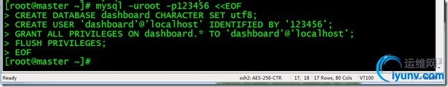

创建一个dashboard数据库
[iyunv@master ~]# mysql -uroot -p123456 < CREATE DATABASE dashboard CHARACTER SET utf8;> CREATE USER 'dashboard'@'localhost' IDENTIFIED BY '123456';> GRANT ALL PRIVILEGES ON dashboard.* TO 'dashboard'@'localhost';> FLUSH PRIVILEGES;> EOF[iyunv@master ~]#

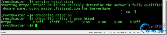

启动服务
[iyunv@master ~]# service httpd startStarting httpd: httpd: Could not reliably determine the server's fully qualified domain name, using master.fisteam2.com for ServerName[ OK ][iyunv@master ~]# chkconfig httpd on[iyunv@master ~]# chkconfig --list | grep httpdhttpd 0:off 1:off 2:on 3:on 4:on 5:on 6:off

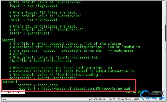

让Dashboard使用Reports,现在默认agent是已经启用Report的功能,所以你就不需要设置agent,你只需要设置Server端就可以
[iyunv@master ~]# vim /etc/puppet/puppet.conf[master]reports = store,httpreporturl = http://master.fisteam2.com:80/reports/upload
重启puppetmaster 服务
[iyunv@master ~]# service puppetmaster restart

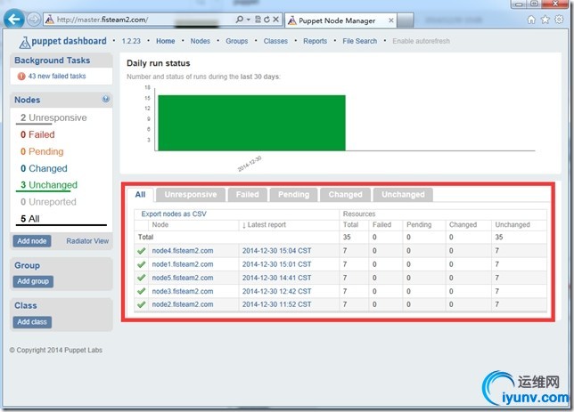

这时候就可以直接用 http://ip 访问puppet Dashboard
导入报告
[iyunv@master puppet-dashboard]# cd /usr/share/puppet-dashboard/[iyunv@master puppet-dashboard]# rake RAILS_ENV=production reports:import
这时候你访问Dashboard,可以看到导入的任务.
4. 执行导入的reports
[iyunv@master puppet-dashboard]# cd /usr/share/puppet-dashboard/[iyunv@master puppet-dashboard]# rake jobs:work RAILS_ENV="production"

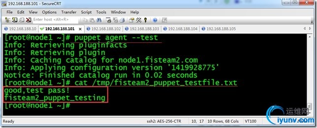

一个Master,五个node测试效果
文件同步测试
Puppet master:
[iyunv@master ~]# vim /etc/puppet/fileserver.conf[fisteam2filesync]path /etc/puppetallow *
在下面加一个配置域,名字叫做fisteam2filesync,路径是/etc/puppet

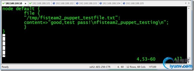

[iyunv@master ~]# vim /etc/puppet/manifests/site.ppnode default {file {"/tmp/fisteam2_puppet_testfile.txt":content=>"good,test pass!fisteam2_puppet_testing";}}
上面的代码对默认连入的puppet客户端执行一个操作,在/tmp目录生成一个fisteam2_puppet_testfile.txt文件,内容是good,test pass! 回车换行fisteam2_puppet_testing回车换行.
初次创建pp文件,需要重启puppetmaster
[iyunv@master ~]# service puppetmaster restartStopping puppetmaster: [ OK ]Starting puppetmaster: [ OK ]

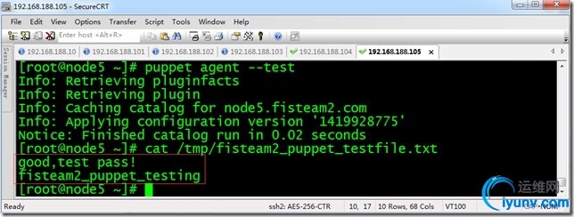

NODE1~5测试
node1:
node2:
node3:
node4:
node5:
