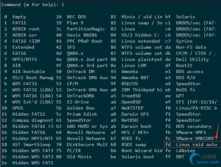

[iyunv@mage 10.19.166.23 ~ ] #查看可硬盘分区情况
# fdisk -l
   Device Boot      Start         End      Blocks   Id  System
/dev/sdb1               1        2871    23061276   fd  Linux raid autodetect
/dev/sdc1               1        1305    10482381   fd  Linux raid autodetect
