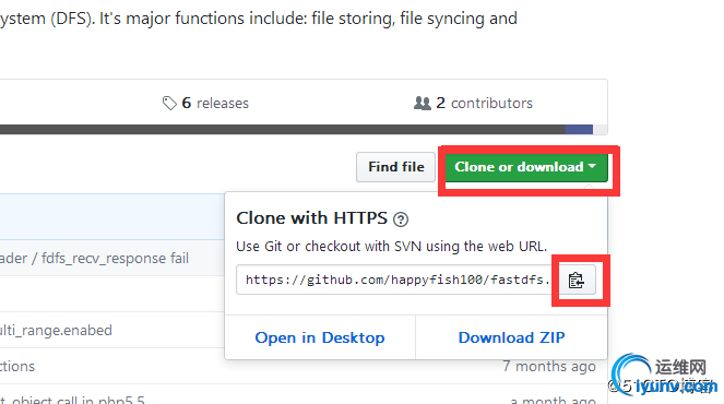

git模块:Deploy software (or files) from git checkouts
在websrvs每个节点上yum install git
访问此https://github.com/
搜索fastdfs
watermark,size_16,text_QDUxQ1RP5Y2a5a6i,color_FFFFFF,t_100,g_se,x_10,y_10,shadow_90,type_ZmFuZ3poZW5naGVpdGk=.jpg
[iyunv@node1 app]#ansible websrvs -m git -a "repo=https://github.com/happyfish100/fastdfs.git dest=/app/fastdfs"  [url=]\\可以在github上下载软件或者文件到远程多台主机[/url]
