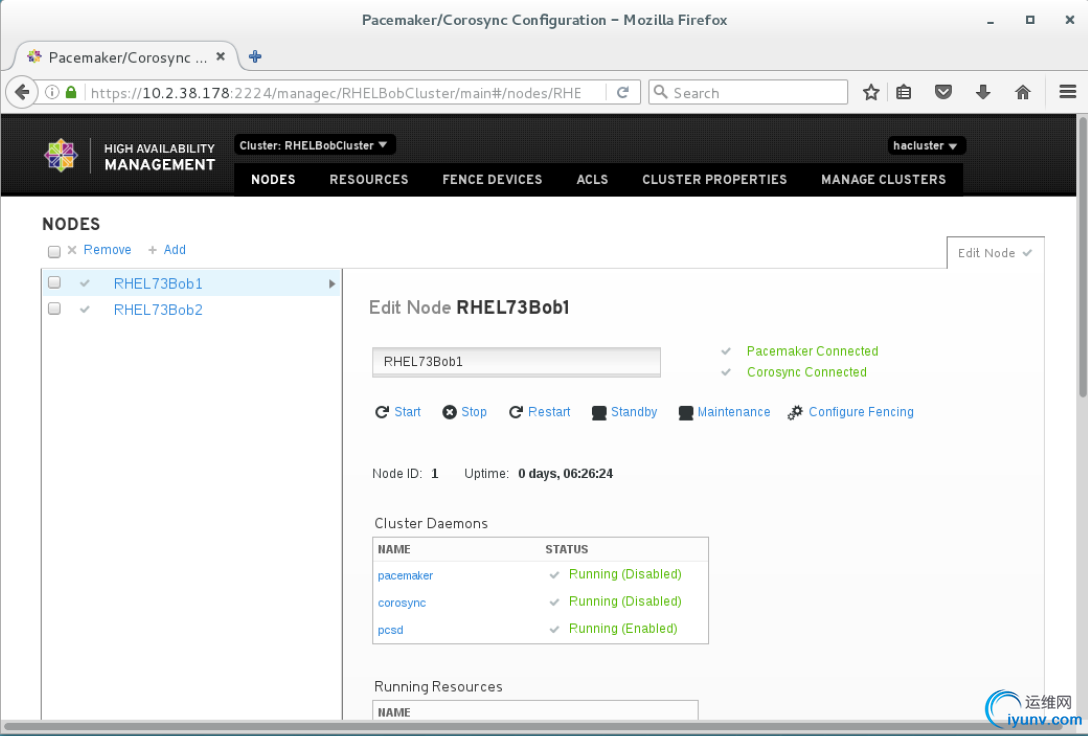

  • Pacemaker是一个在Linux上很成熟的开源高可用性集群。下面这个站点介绍了Pacemaker GUI的使用:https://keithtenzer.com/2015/06/22/pacemaker-the-open-source-high-availability-cluster/?utm_source=tuicool&utm_medium=referral:
